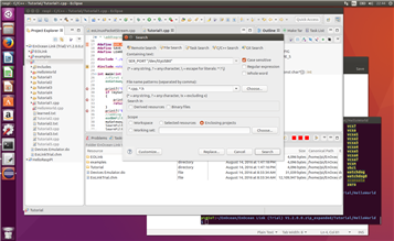

Setting the sources for the Raspberry PI serial
By default the sources of the Tutorial and examples projects of the EnOcean Link package defines the serial port device as USB0
#define SER_PORT "/dev/ttyUSB0"//! the Serial Port Device
To make the programs running on the Raspberry PI we should change this define to the following:
#define SER_PORT "/dev/ttyAMA0"//! the Serial Port Device

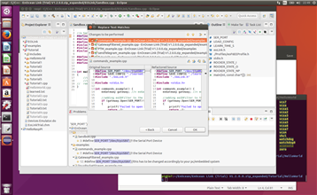

This action should be systematically applied to all the sources in both the projects examples and Tutorial. This task can easily be done in the Eclipse IDE environment with the multiple files search and replace as shown in the images below:
Note: not all the sources refers to the ttyUSB0, some other define the serial port as ttyUSB1
As many programs includes some message referring to the USB300 connection port for completeness it is better to replace also this detail with the text ttyAMA0. This operation has not influence on the program functionality or behaviour.

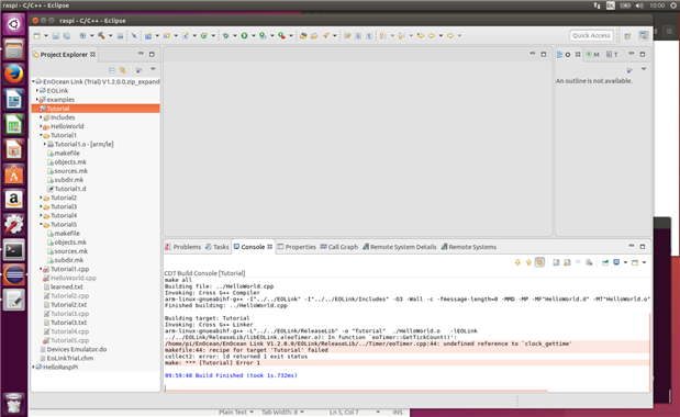

Issue cross compiling EnOcean programs

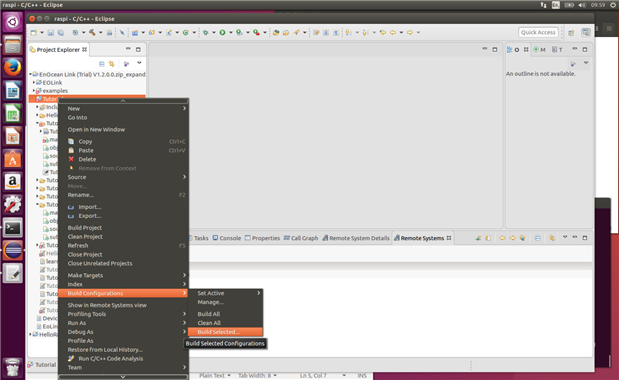

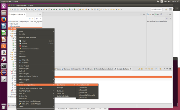

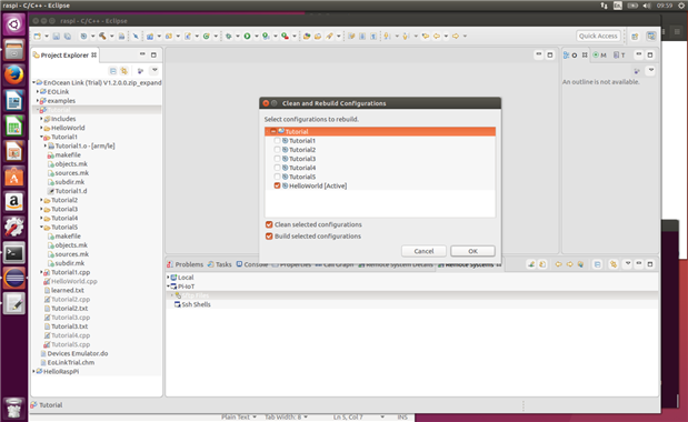

After everything has been setup correctly we will try to compile en EnOcean provided program. As expected the most simple is just the HelloWorld. All what we should do is to launch the build of the properly set Build Configuration.
At the end of every cross compiling of program that link the EOLink library we get an error !!!
/home/pi/EnOcean/EnOcean Link V1.2.0.0/EOLink/ReleaseLib/../Timer/eoTimer.cpp:44: undefined reference to `clock_gettime'
makefile:44: recipe for target 'Tutorial' failed
collect2: error: ld returned 1 exit status
make: *** [Tutorial] Error 1
To explain this in few words, this seems an known issue related to the time component; it is not a EnOcean software issue but it is of the cross compiler toolchain. There is a library used by the cross compiler that is not of the same version than the one used by the Raspberry PI Debian environment.
As a matter of fact, according with the StackOverflow article How to upgrade glibc from version 2.13 to 2.15 on Debian? - Stack Overflow it is possible to upgrade this library. At the actual date this operation is strongly discouraged as the replacement library is only in the deb http://ftp.debian.org/debian experimental main repository, considered not reliable for any kind of production or normal development environment. If you want to try, it's at your own risk.
