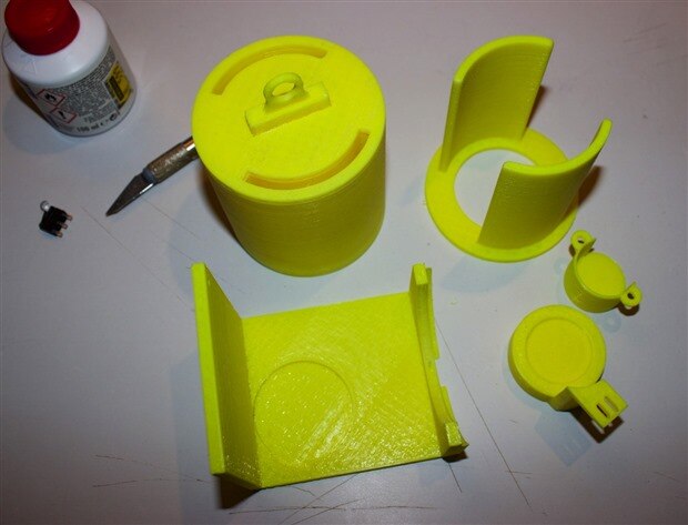

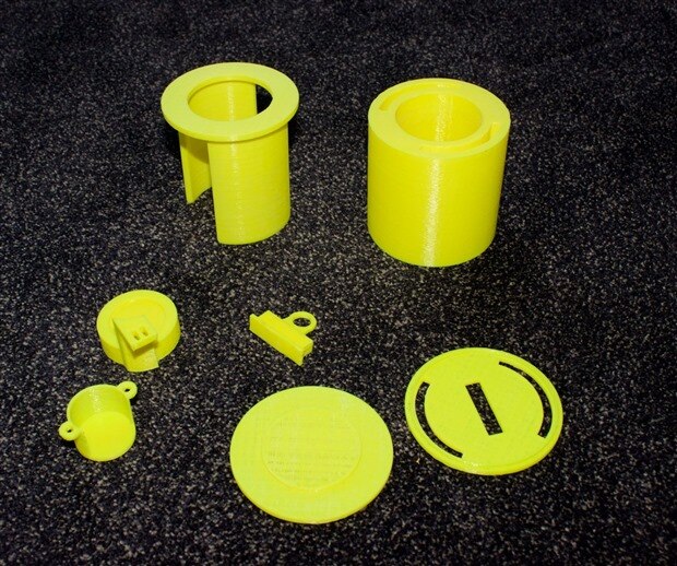

A full m-Pix structure is compound of 10 parts.
The above image shows seven finished elements: the three parts of the moving cylinder, the support and the motor and levers holder. Below we see in detail the printing process of these parts.

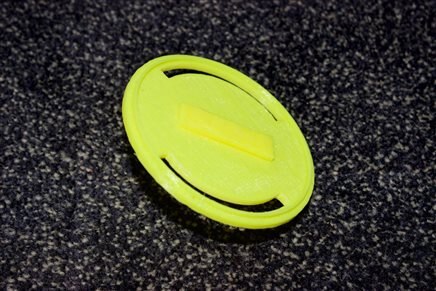

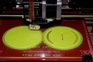

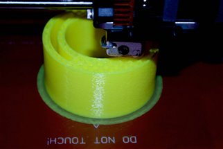

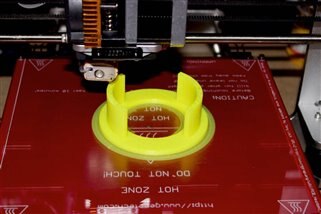

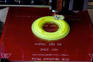

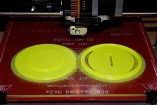

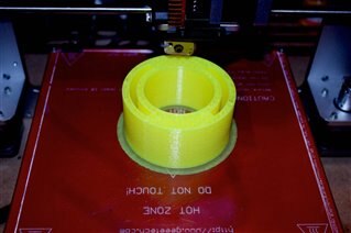

The cylinder and the levers joint
The images above shows four moments while printing the top, bottom and central part of the moving cylinder. These parts should be lightweight and are not subject to particular mechanical stress; to reduce the printing time and the weight these three parts are only 20% filled with 0.6 mm to the external skin thickness. It is sufficient to refine the surface after printing without consuming too material.
The choice to make the cylinder in three parts simplifies the assembly with a more flexible 3D printing strategy.

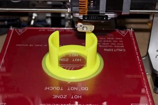

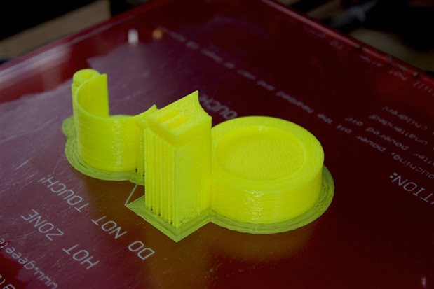

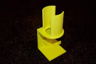

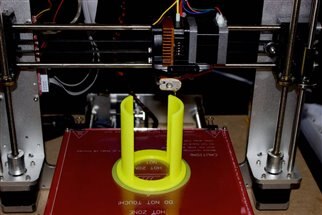

The above sequence shows four steps of the 3D printing of the support. This part act as a guide for the moving cylinder and fit inside it; this made possible to use few material - always 20% filled - but granting a good positioning of the part: the cylinder moves vertically and avoid rotating without generating friction.
Above the levers joint. is a small piece but it should connect the motion levers; it is 3D printed with 100% fill and is glued internally to the bottom cover of the cylinder.

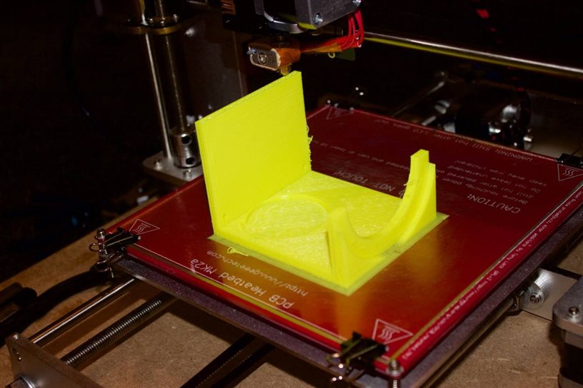

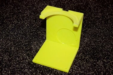

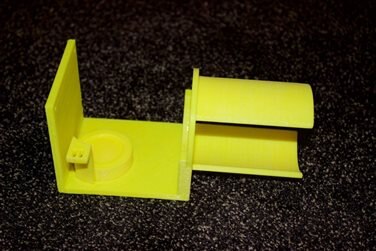

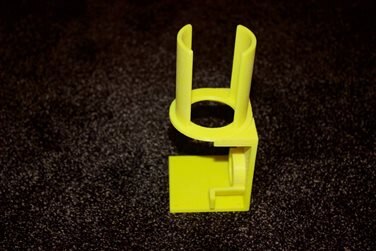

The motor support
The 3D printer motor support - including the end-stop switch support - is built in two parts. The reason is the same: speedup the 3D printing time with lower filling but making a robust component.
The base of the support (the rightmost in the above image) is almost large and includes the switch support. The motor holder is kept separate and will be glued over the other inside the engraved area. This gives a perfect positioning and the option to rotate the holder for last minute adjustments.
These parts are 3D printed with a 30% filling.
The m-Pix base
This is the main structure support that will hold the motor and the moving parts.
As shown in the 3D printing sequence above also in this case the printing fill density is only 25%. Adopting a solution with the motor supports glued in the engraved area visible in the fourth image the movement forces impact on the structure in a direction aligned with the filling support. Indeed the base is almost flexible to compensate some unexpected mechanical stress when many modules are assembled together.
Assembling the components

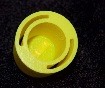

Using a special product perfect for the PLA and PVC the parts are glued together. The first step is assembling the bottom of the cylinder with the lever joint: should be glued internally then the cylinder can be closed with the top and bottom parts.
The images above show the cylinder bottom cover with the joint glued. Note that the cover has a relief circle to keep it in position with the cylinder body.
Now the cylinder can be closed with the top cover as shown in the images below.

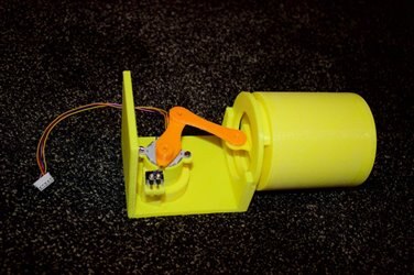

Assembling levers and motor

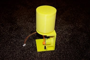

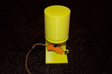

Every module uses a 28BYJ-48 geared stepper motor controlled by a LM298 based motor controller. The controller will be wired externally from the m-Pix while the motor is fixed in the motor support glued to the base. In addition a ultra subminiature micro switch by Omron is used as end-stop for self-position the m-Pix to the lower point. The datasheets of the components are attached below. The images below shows the motor and the linear motion transducer levers. The prototype is complete and all the parts works correctly. The next step will be controlling the movement.

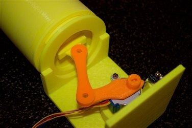

About the levers motion transducer
The detail images below show the geared stepper motor connected to the transducer levers acting like a camshaft. Thank to shabaz suggestion the easiest way to fix the first lever to the motor shaft was to 3D print the collector about 0.25mm smaller then fit it inside with hot air. The motion has no impact on the lever locking as the motor shaft impress a torsion to the component and it remain in place without risk.

    amgalbu over 10 years ago in reply to kulky64 +2
    Hi kulky74 This is just a crank mechanism so the motion of the piston is a simple harmonic motion that goes with the sine of the angle Not so important in this application but that is
  • amgalbu
    I don't think this application requires that kind of precision in linear positioning. Probably (as Enrico may confirm) a linear approximation of the slope of the sine wave is more than enough

    balearicdynamics over 10 years ago in reply to amgalbu
    Absolutely yes Ambrogio!
    The step changes are about 255 and the gaussian is not involved in calculations as it is sufficient a decimal multiplying factor in the number of steps. Also because the component has a very small excursion. As well as the entire curve calculation is usually not need in most of similar camshaft applications where it is just the top and bottom points that matter in the movement.

    balearicdynamics over 10 years ago in reply to kulky64
  • kulky64
    kulky64 over 10 years ago in reply to amgalbu
    ...the motion of the piston is a simple harmonic motion that goes with the sine of the angle
    Not quite. The relationship between shaft angle and cylinder displacement is:
    where x = OD, r = OB and l = BD. I plotted this equation for r = 30 mm and l = 40 mm and it looks like this:
    According to me this relation IS important, because if you want to put the cylinder into some known position, you need to calcute the shaft angle to get to this position.
