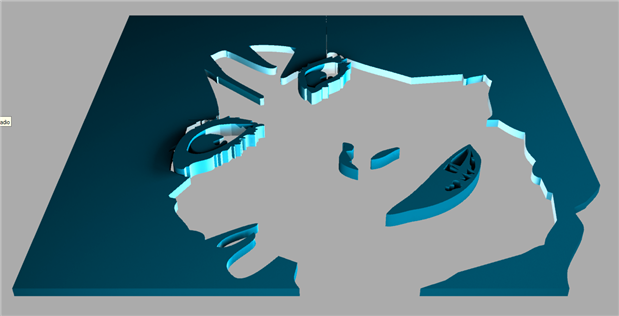

Before creating the entire mechanics to make the Art-a-tronic live I proceeded generating a simplified proof of concept including only the black components of the image. Every element has been fixed to a thickness of 5 mm. with the eyes and the lips more prominent than the hairs components.
{gallery} 3D proof of concept
The surfaces extruded by 5mm
Rendered model: 3D front view (original size is 30x30 cm)
Rendered model: 3D perspective view (original size is 30x30 cm)

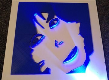

3D printing the proof of concept
The rendered images with a lateral light the effect sounds good so the further step is to see if we can represent the same effect in the real world.
Some information on the printing parameters
  • Filament: PLA deep blue
  • Filament diameter: 1.75 mm
  • Nozzle diameter: 0.4 mm
  • Layers Thickness: 0.2 mm
The images below shows the results obtained. It is the worth to turn the page and move to design the mechanics of the movement.
