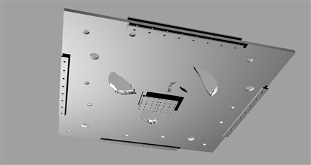

The white base covers two roles: it is the visible support of the Art-a-tronic including the fixed parts (the white background n the flat image). When in standby the moving blue components should appear at the same level so the white visible parts are extruded.
As shown in the above images the base (white) contour has been reduced a while to permit the up-down (blue) movement.
The base is also the support of the entire structure; an external border is provided to make a frame helping to assemble the four parts in a single solid element. To slide vertically the moving objects we should include a support plane moved from the bottom by the stepper motors. This requires and extra 2mm engraving in the base (white) to host the support surface.
The images below shows the rendered base model.

Due the 3D printer limits - the max printable area is few less than 200x200 mm - every part is built with four separate elements. Thus we should add extra-components to keep together the final structure.
Two supports (top and bottom) has been added to every side of the frame and a rectangular support complete the final building to the bottom center of the ideal cross separating the four sectors.

The four parts of the (blue) hairs lays on the (white) base but the remaining three parts (requiring other three motors) follows the opposite logic: eyes, nose and lips are pushed from the bottom emerging from the base holes. These parts are self-guided inside the base.
In the eyes, nose and lips the top supports have been removed so the components height includes the thickness of the base layer.
