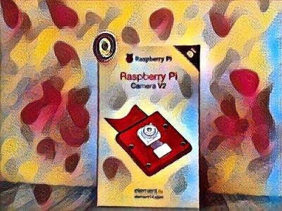

After this the fast neural style example from pytorch / examples works, but because of the limited amount of RAM of the Rpi it works only for smaller resolution images.

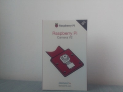

Here is candy model applied to an image taken with RaspiCam, and down-scaled to 400x300:
model image:
The transformation takes about 1 minute on the Rpi.
