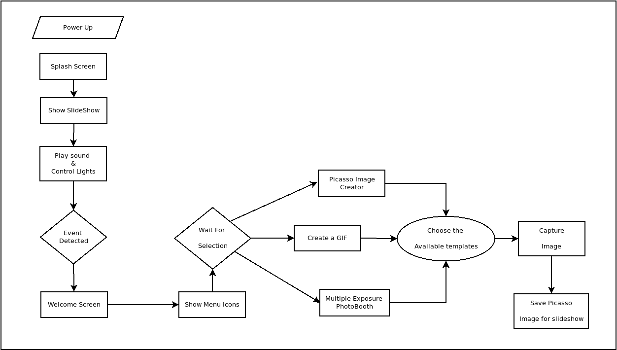

Below is the brief flow of the whole system that would involve first boot, splashscreen, slideshow and various other features.
So considering all these things, I have divided the whole build into three parts namely:-
1. Software
2. Hardware
3. Cabinet
I will define each and every part, currently I have not decided as to which part to be done first but more or less the broad idea of development is at the back of my mind.
The Software

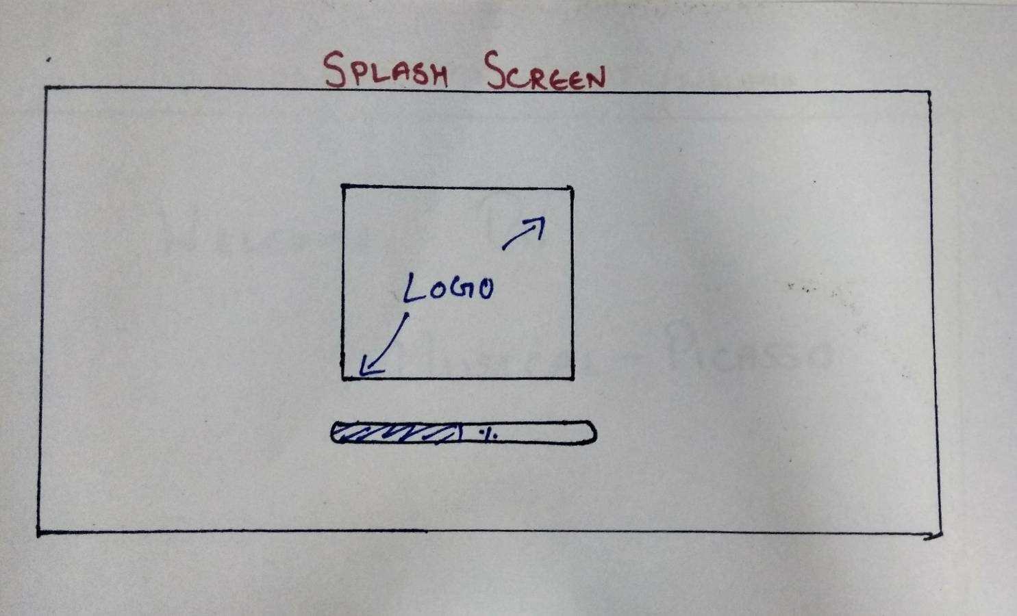

The elegancy of the final build and overall user experience would totally depend on the software performance and the make. I have decided the workflow of the system in terms of software. Below is the block diagram of same that shows the working right from the boot.
To justify the diagrams, I would say that :-
1. The system powers up and a flash screen is displayed with musical picasso logo

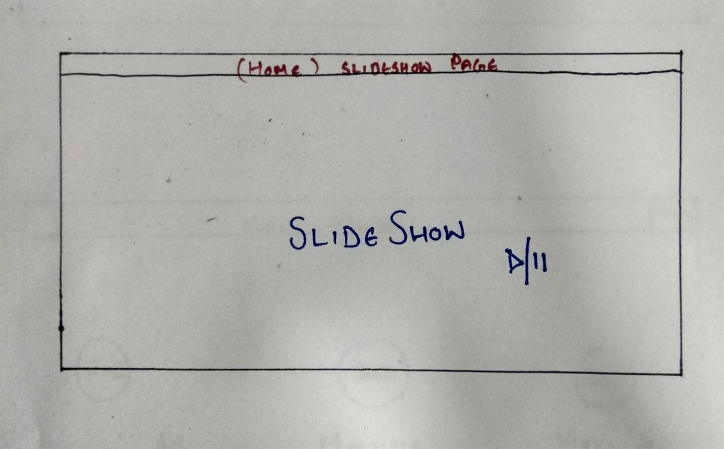

2. As soon as the boot process is complete it will start showing the slideshow of existing images on the device
3. At the same time back RGB light would be lit along with the LED lights of the room
4. The audio would be played in accordance with the lightning

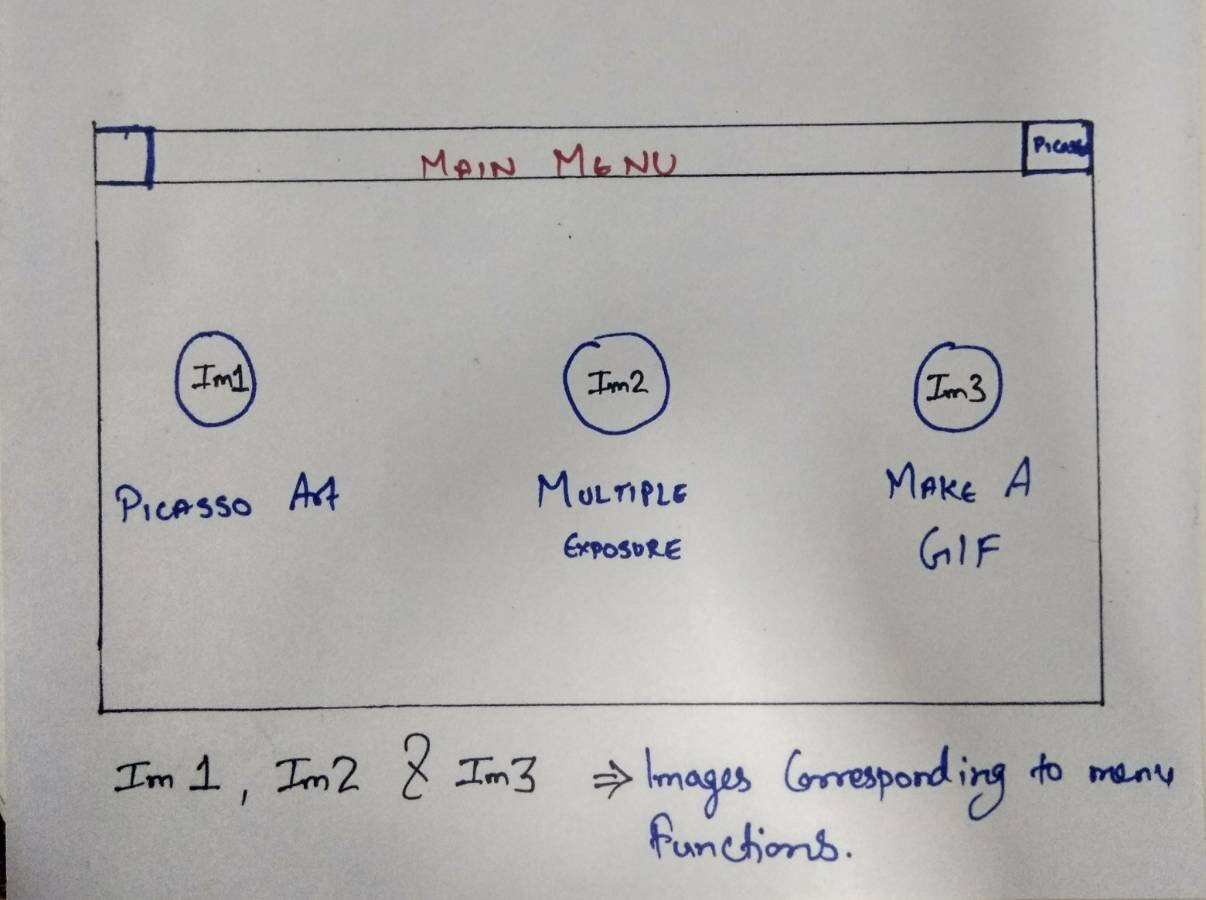

5. Now as the user presses any button, the welcome screen and main menu with icons would be displayed
6. User can choose the functionality as per required.
     a.) Picasso Image Capture
     b.) Multiple exposure image capture
     c.) Make a GIF
7. As per the choice, corresponding function would be done and slideshow again starts

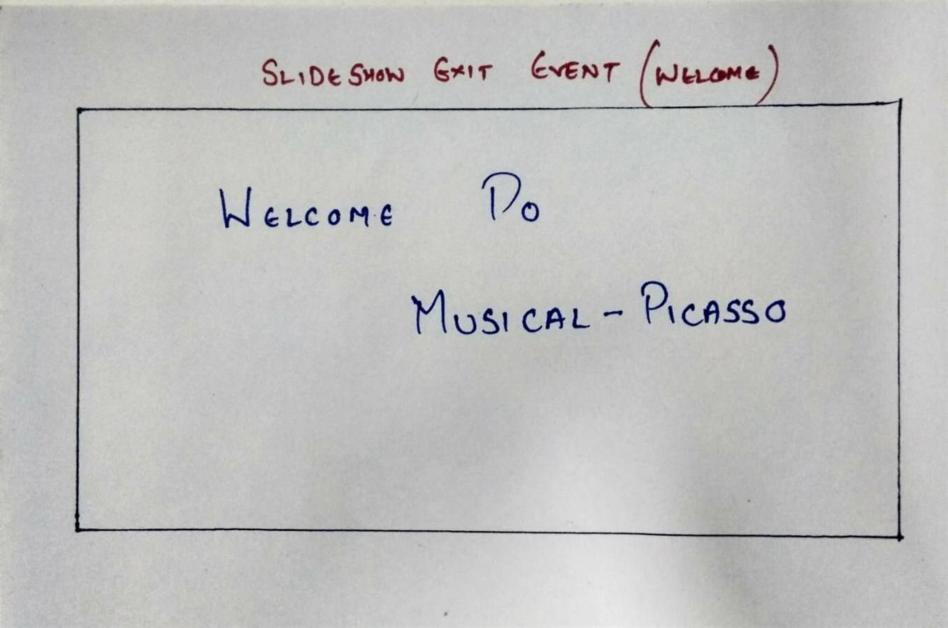

{gallery} My Gallery Title
This screen appears after the escape sequence of slideshow

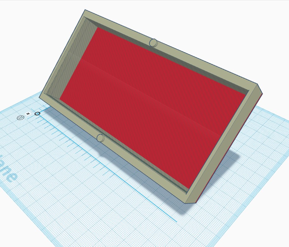

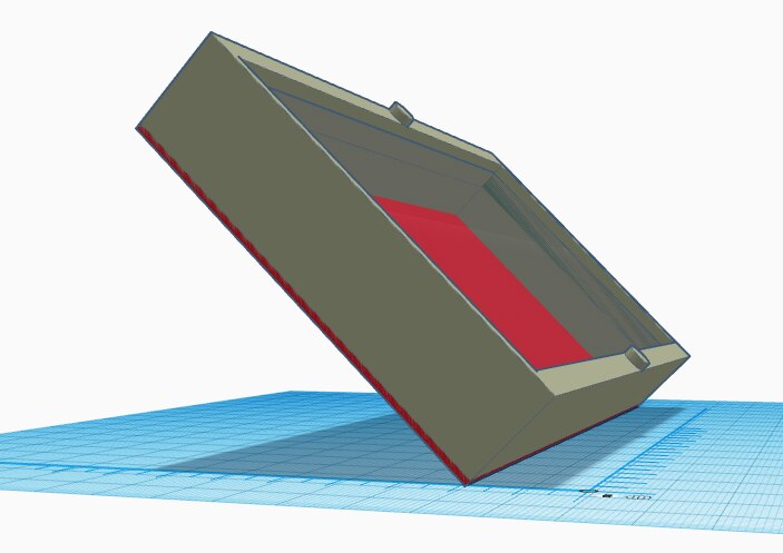

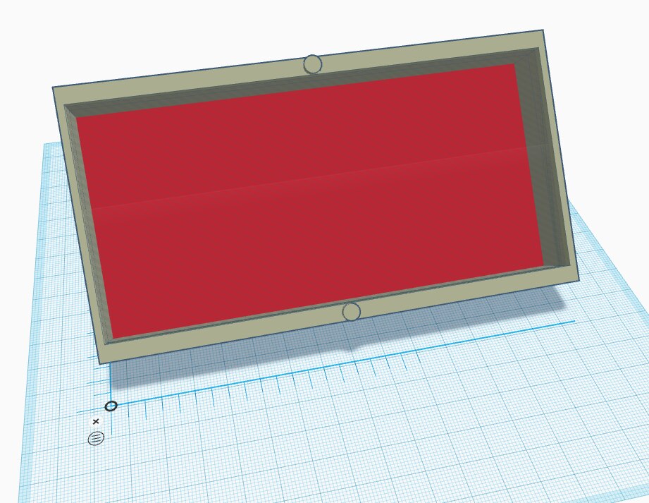

The Cabinet Build
This is more or less finalized however I have to first get my hands on a screen since currently I am just testing the software functions on a spare lcd monitor. So it would be a cabinet with besel for the LCD. It should be able to house all the required hardware and the camera module as a top center notch.
There would be a notch at the bottom of the LCD also for the IR remote control.
