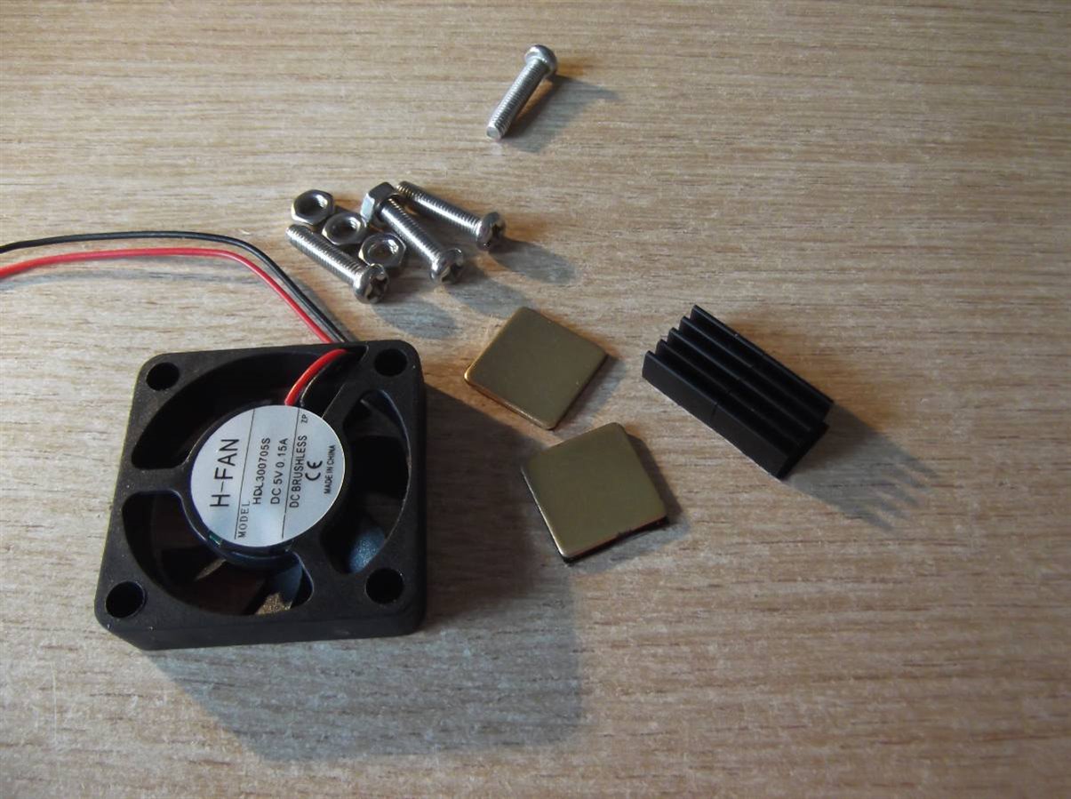

I did have some parts left after assembling the display, one is a fan, presumably to try and keep the Pi cool as I guess a hot Pi may melt the plastic. plus what look like a couple of small heat sinks. Not sure where they might go. There was nothing in the instructions. Anybody any ideas?

    Hi Dubbie, Great progress and looking good. It is a very interesting project. The heat sinks are for the Broadcom chip and some others can be cooled as well. I have used the aluminum ones with the fins…

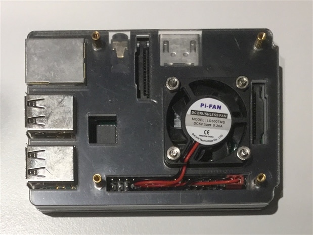

    RPi with fan and heat sink. Heat sink peeking out under left side of fan opening. The RPi won’t melt the plastic but it will slow down under a heavy load to keep the chip from overheating when heavily…

    RPi with fan and heat sink. Heat sink peeking out under left side of fan opening.  The RPi won’t melt the plastic but it will slow down under a heavy load to keep the chip from overheating when heavily loaded without the fan.
    EDIT:  I have only used this on 3B and not 3B+

    Hi Dubbie,
    Great progress and looking good.   It is a very interesting project.  The heat sinks are for the Broadcom chip and some others can be cooled as well.  I have used the aluminum ones with the fins and they help but adding the fan cools much better.  See this post by Shabaz: Raspberry Pi 3 Cooling / Heat Sink Ideas    My experience using a case similar to yours was the same as the observations by Shabaz.
    EDIT:  also see part 2 of the post by Shabaz here: Raspberry Pi 3 Dynamic Current Consumption, Power and Temperature Tests
