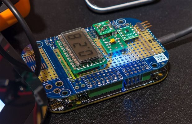

Having recently been experimenting with Pi 3’s and displays, analog-to-digital converters (ADCs) and a very high speed data logging multimeter from Keysightvery high speed data logging multimeter from Keysight, the stars aligned to allow me to measure several parameters to get to know the Pi 3 a bit better.

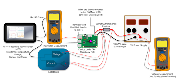

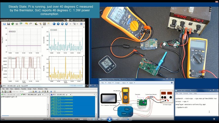

Test Bed Topology

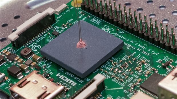

A Pi 3 was used that had previously been connected to a heat sink and thermistor.
There is more information on that here, but in summary a ceramic heat sinkceramic heat sink was used (Note: I used a different ceramic heat sink but it is out of stock; the one linked here is a suitable replacement) because it has far lower thermal resistance (10.1 degrees C per Watt) compared to the traditional little stick-on aluminium heat sinks like this Raspberry Pi Heat Sink Kit that has a 25 degrees C per Watt thermal resistance value.
The ceramic heat sink achieves the excellent low thermal resistance because it has a micro-pores that can dissipate heat extremely well.
The thermistor used was Betatherm 100K6A1BBetatherm 100K6A1B and it was small enough to be able to be pushed into a hole that could be drilled in the heat sink.

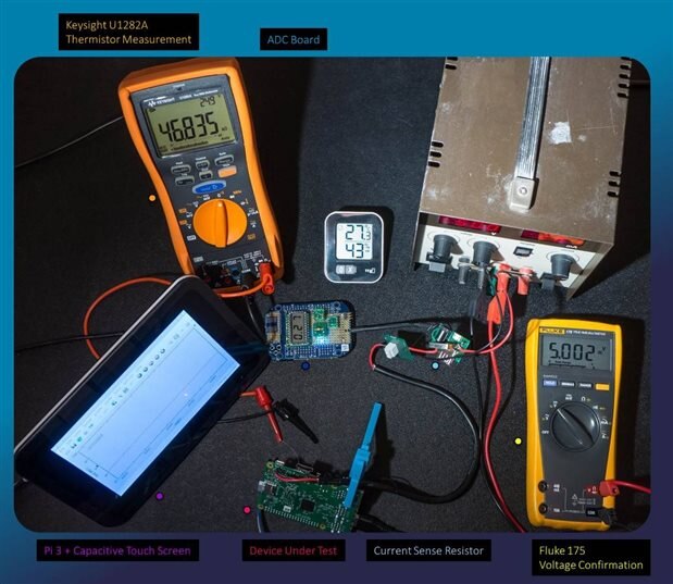

A Keysight U1282A multimeterKeysight U1282A multimeter was used to capture the thermistor resistance measurements. It is very fast (10 captures per second) so that even subtle short changes in temperature can be easily detected. In fact the combination is sensitive enough to detect the heat given off by a laser pointer beam (which is less than 1mW).

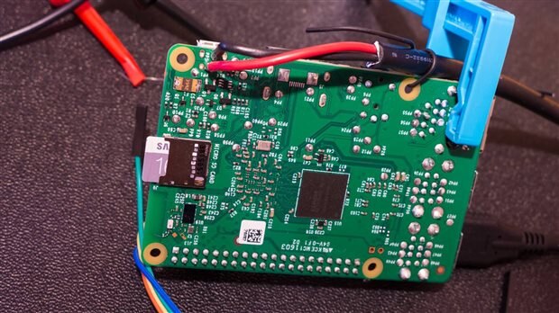

To get power into the Pi 3, the official power supply was not used; instead a 4A capable bench supply was used with short thick wires. The wires were 16 AWG in size (1.29mm diameter) compared to the 18 AWG (1.02mm diameter) wires in the official 2.5A power supplyofficial 2.5A power supply. The wires were directly soldered to the underside of the Pi (to the test pads marked PP2 and PP5 for +5V and 0V respectively). It was tricky – 16 AWG wire is fat! To avoid ripping of the pads, the wire needed to be tied in place for a bit of strain relief.

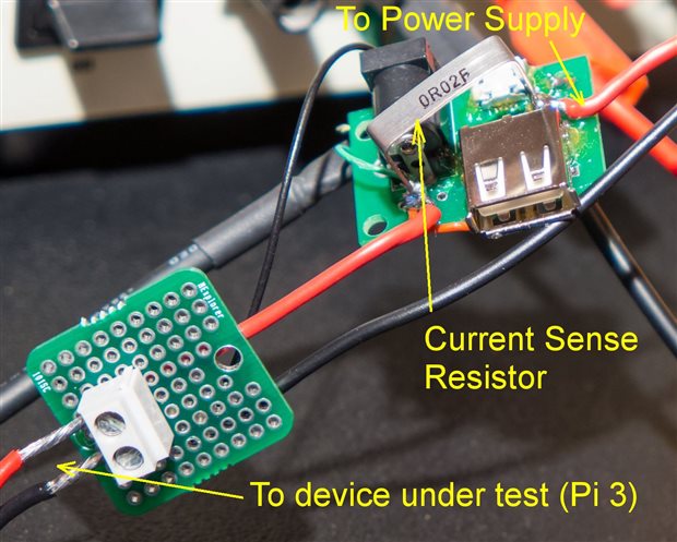

Some known resistance is needed to ‘sense’ the current through the wire (and hence the current through the Pi). A 20 milliohm resistance was used for that purpose (you don't need it to be anything near as large as the one in the photo but it was all I had at hand; a 0.5W resistor will be sufficient). Incidentally the other connectors on the board are not relevant, they are for unrelated experiments).
The voltage across the resistance is proportional to the current going through the Pi (Ohm's law). The voltage can be measured with a multimeter or by using an analog-to-digital converter. (ADC). An ADC was used because I don’t have many logging multimeters. The accuracy of the ADC was determined before-hand with some known resistances and a handheld multimeter. The ADC reading is accurate to within a few milliamps (the software can self-calibrate to remove any offset, and gain error was removed through calibration by using a known load and confirming with a multimeter). If there is interest, let me know in the comments and I will write up the ADC project. It was designed to provide an accurate way to measure the power that USB devices consume dynamically.
The data from the  U1282AU1282A multimeter and the ADCs is collected up and graphically displayed using the kst’ application. It was actually possible to do all this using another Pi (and a 7 inch touch screen) so that it could be conveniently monitored for extended periods. But for the purposes of obtaining screen shots for this write-up, the software was run on a normal PC.
Running Tests
Not a lot of testing was done; the Pi was powered up and measurements taken with the Pi doing nothing (just running Raspbian with nothing connected up). A  few stress tests were run (in particular a Sysbench command that computes prime numbers and a stress command that makes all four cores work continuously, and a cpuburn-a53 program which exercises ARM NEON functionality (ARM NEON is hardware inside the SoC that is used by software libraries for accelerating math functions). I also tried using omxplayer to use the graphical processor unit (GPU) slightly.
For each of these tests the temperature, voltage and current were monitored in real time (and the power was computed in real time using Power = Voltage x Current). All tests used the Pi with the ceramic heat sink attached and no enclosure. Ambient temperature was around the 25 degree C ballpark and was uncontrolled.

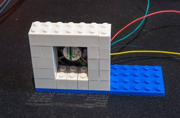

After these tests were run, a small fan (25x25mm) was positioned a few centimetres away from the heat sink and run at full speed. It ran at 5V and consumed about 80mA. With the fan running, a couple of tests were repeated.
The fan was just positioned using some Blu-tack (putty) holding it against a Lego aperture that acted like a short air duct.
To run the tests I had to get my desktop/dashboard looking organized slightly! Dynamically updating charts are on the left, the Pi console is at the bottom (SoC reported temperature is in the blue window at the bottom) and the remainder was used to show the live action or any screenshots and the topology and any commands I would need to paste into the console. At top-left any observations/conclusions are displayed in a blue box.
For the detailed results there is a 30-minute video recording (right-click to open in a window to allow full-screen) which was done in one take to make sure no subtle data was lost, with no pauses except for a 5 minute period which is marked in the video during which time I was waiting for the temperature to drop after a test, and another break during which time I added the fan.
If you don't want to sit through a 30-minute video here is the exec summary:

Here are the results with just the heat sink and no fan:
Scenario #DescriptionCurrentTemperature reported by SoCTemperature measured by Thermistor
1Pi doing nothing. Rasbian running.266mA46°C41°C
2Pi running omxplayer, playing a file on the Micro SD card (connecting or disconnecting the HDMI plug made no difference)285mA
3Calculate Primes using sysbench365mA
4Running stress --cpu 4670mA75°C67°C
5Running cpuburn-a531.45A85°C75°C
It can be observed that the temperature was very high for the last couple of tests; hot enough to literally fry an egg. This was with a good heat sink (10 degrees C per Watt thermal resistance) nevertheless throttling was observed during test #5. The throttling effects are in the video and that part is worth observing.

After this, the fan was applied and a couple of tests re-run as mentioned (results are in the video). It improved the situation despite being such a tiny fan.

If a fan is used, the 25x25mm one was effective (you can see the reduction in throttling in the video) but it didn’t eliminate throttling entirely for the last scenario although the effect was greatly diminished. The last scenario could be considered by some to be extreme though. It really depends on how the Pi is deployed.
