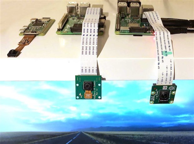

Raspberry Pi 3B+ and Raspberry Pi Camera V2
Thanks to Element14 for providing the new Raspberry Pi 3B+, Kit, and Camera for this challenge.  The RPi Zero W (left) was not tried but it would probably struggle to manage OpenCV for this application.  I have successfully used a Raspberry Pi 3B with the original camera (middle in the photo above).  But the new Camera V2 on right gives better color balance in mixed lighting and for my use is a substantial upgrade over the original.  And the 1400 MHz clock in the RPi 3B+ improves over the 1200 MHz RPi 3B for facial recognition where update frame rate speed is important.  So the current plan is to use the RPi 3B to display and control art while the RPi 3B+ does facial recognition.
