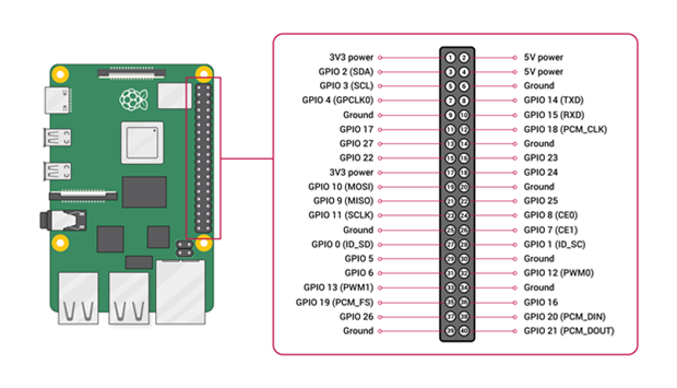

Raspberry Pi 4 Pin Configuration

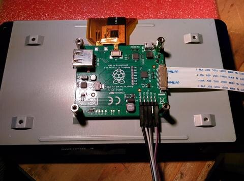

Connection:
i.Connect Ribbon cable from Display to Raspberry Pi
ii. Connect SDA to Raspberry Pi SDA pin and connect SCL from Display to Raspberry Pi SCL pin
iii. Connect Ribbon cable from camera to Raspberry Pi
iv. Connect GND from Display to Raspberry Pi GND
v. Connect 5V from Display to Raspberry Pi 5V

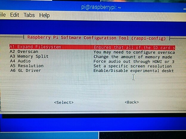

Step #1: Expand file system
$ sudo raspi-config
In the “Advanced Options” menu select “Expand Filesystem”, select the first option, “A1. Expand FileSystem”, click “<Finish>” button, and then reboot your Pi

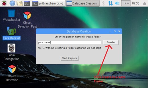

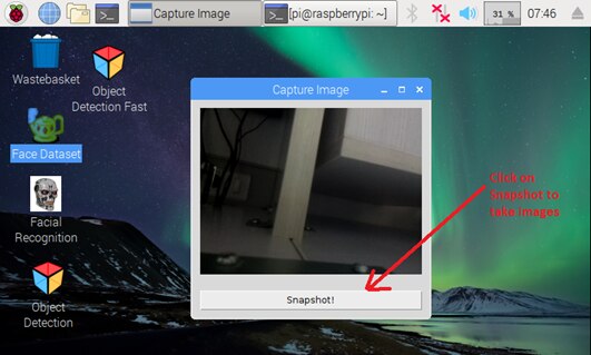

step #1
Run the file faceDataset.py, a dialog window will open, enter the name of the person whose images are to be stored. If the name is not entered the folder will not be created. This is the folder where all the images of that particular person will be stored and is required for further processing.
$ python3 faceDataset.py
Click on create and then click start capture.
An image capturing window will open click on Snapshot to take the photos of the person. It will store a single image every time you click on Snapshot. Take at least 6-7 images in the different face position, for example straight, tilt and side pictures. Close the window when done.
To create the multiple person data repeat the previous step
NOTE: If numerous person data are stored, the encoding time will increase, as the raspberry pi is a low power computer it will take more time to process, and the facial recognition will run slower.

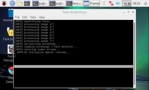

Run the file face_recognize.py .
$python3 face_recognize.py
A window will open and shows the processing image. The processing time depends on the number of images stored.

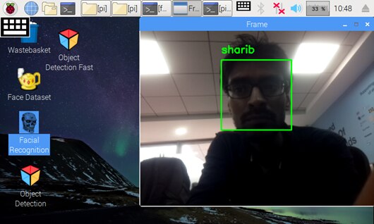

After processing the images, the "Frame window" will open, when the camera detects the person's face, it will show the name of the person if its matches with the images in the database. Press Q on the keyboard to close the Frame window.
