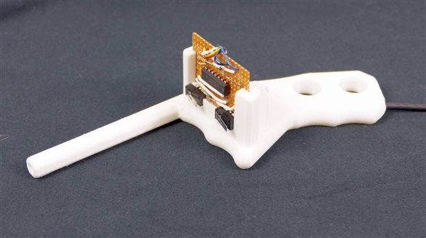

I decided the PiCassoTizer needs a wand to act like a touch screen paint brush with mouse functionality.
I was going to give it a fancy name, but all the cool names I thought of sounded too pretentious.
The features it needs are:
  • and ergonomic grip
  • a reflective pointer
  • 2 microswitches to emulate mouse buttons
  • a debounce circuit to permit accurate button activity
The following video shows the wand construction, the circuit and its performance:
Here is a picture of the switches wired on a strip board with 2 SPDT microswitches:
This is the debounce circuit implemented on the circuit board:
Here is what the 3D printed wand looks like:
Here is what the circuit board and switches look like when inserted in the wand:
Here is what the cable looks like in its channel:
Here is a picture showing typical switch bounce (in green) and the cleaned up output (in yellow):
This part of the project is relatively simple, but it takes a surprising amount of time to design, build, troubleshoot and blog about something even this simple.

    balearicdynamics over 7 years ago +5
    I start seeing the light, Doug, a very good new step. The design of the wank looks very good, a mix between ancient and new tech. Do you plan to close the circuit side too? BTW, I am sure you will get…
    DAB over 7 years ago +5
    Good idea, what better to do point and click than a wand. DAB
    genebren over 7 years ago +4
    Nice addition to your project! Looks like a good ergonomic design. Gene
    Gene
    dougw over 7 years ago in reply to genebren
    If it really works well, I may make a cover for the circuit card.
    I might even make a PCB - which would be much smaller than the strip board.
