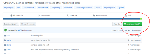

Finally I could clone the github repository! Since I have never used github before, I had to do some rummaging online to figure this out. Github is an online host for private and public code. It stores original code and then any revisions that get pushed up to it. That way if you mess up your code, you can always download an old version that you know works. Cloning a repository is like downloading the code to your own computer. On the github page for the code you want, just above the list of what is stored in that repository, on the right, is a button that says "clone or download."
This will give you a web address such as https://github.com/Nikolay-Kha/PyCNC.git . On the raspberry pi, from the terminal you make sure you are in the directory where you want this code and then write the command "git clone https://github.com/Nikolay-Kha/PyCNC.git" and then it will copy the code onto your pi.

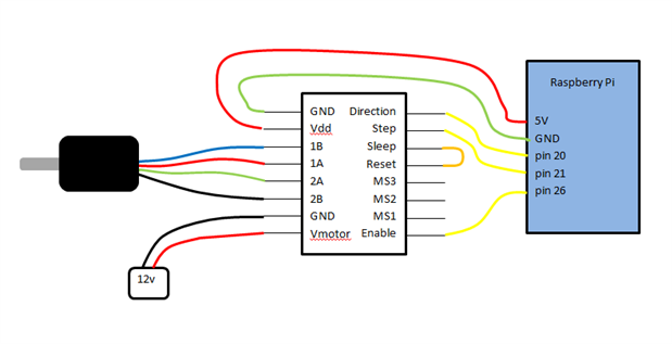

PyCNC gives step, direction, and enable outputs, so you have to use an A4988 or DRV8825 driver board to interface with the stepper motors. Here's the pinout from the readme section.

To test this, I decided to just hook up a motor to the x-axis. I wired my stepper motor to the driver board and the driver board to the pi as shown below.

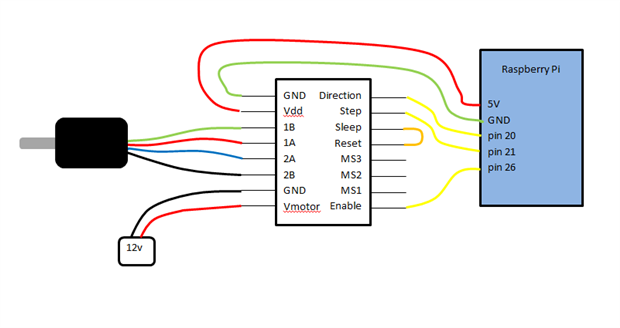

To run the PyCNC file, you navigate into the PyCNC directory and run "sudo ./pycnc" and then you can enter gcode manually one line at a time. If you run "sudo ./pycnc filename" it will execute a whole file of gcode (where filename is the name of your file). When I tried running a simple command to move the x-axis, it didn't work and I double checked that my wires were connected correctly. 1A and 1B are for one coil and 2A and 2B connect to the other coil. So I changed my wires to be correct.
It still did not work. After reading some comments on the github page I played around with changing the stepper pulse length. This is done in the cnc folder in the file called config.py. When I changed the stepper pulse length to 10us it moved! The next thing to do will be to fine tune the dimensions such as how many steps per millimeter on each axis (that information is stored in the config file) and I'll have to test a whole file.
