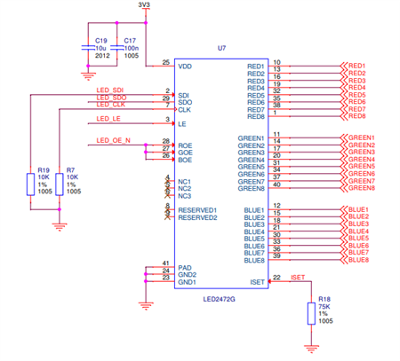

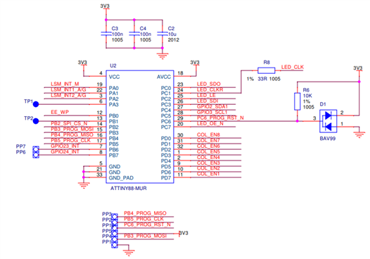

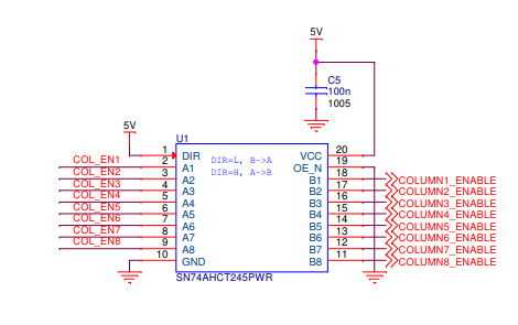

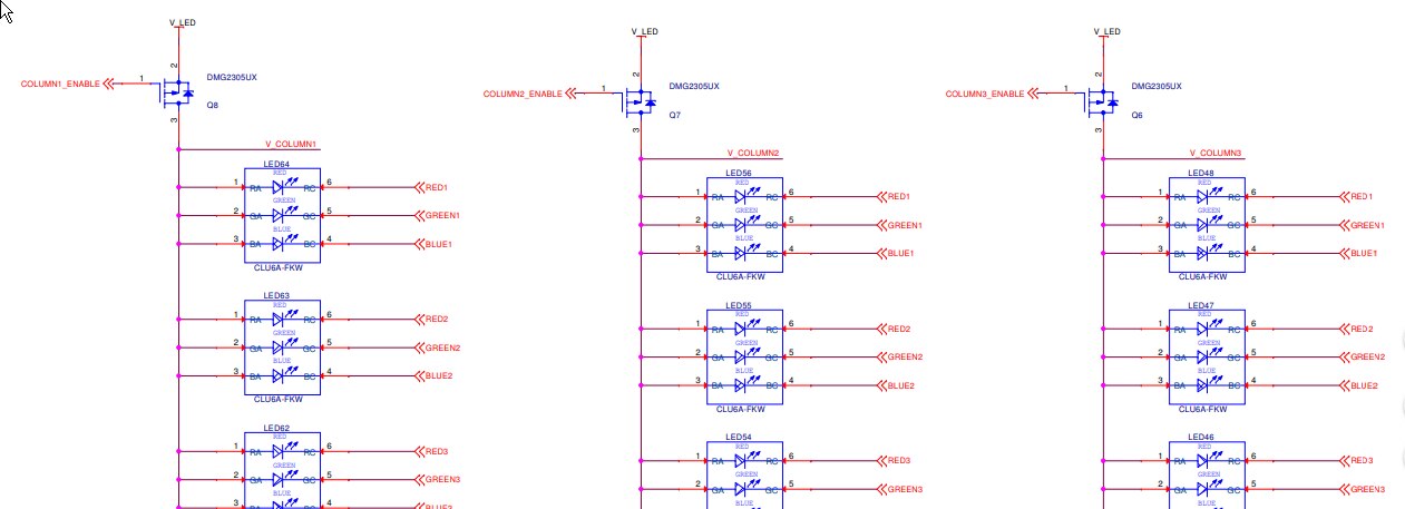

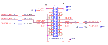

The schematic for the Sense HAT is here. I've attached screenshots of the most relevant parts (which are used to control the LED matrix).
All the sensors on the board are connected using I2C. The LED matrix is driven using a STMicroelectronics LED2472G '24-channels LED driver with error detection and gain control', which is controlled by the ATtiny (which in turn is controlled by the Pi over I2C)

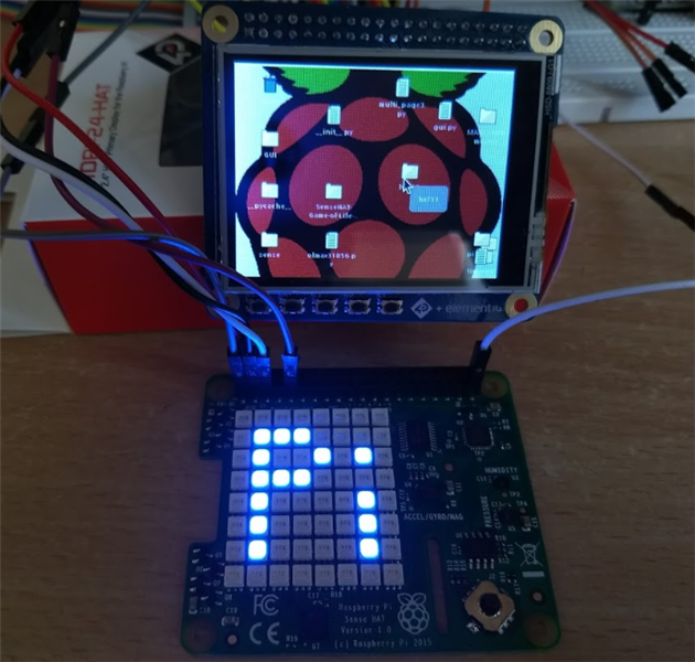

  • I happened to find 'John Doe's' (whoever he is image) code for 'Game of Life' for the Sense HAT. Luckily, it used a custom driver to control the Sense HAT: using smbus instead of the official Sense HAT library.
Testing:

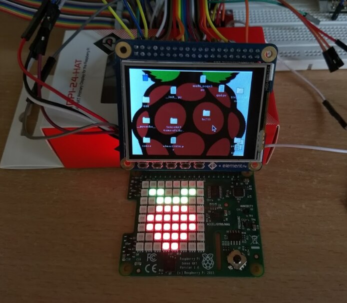

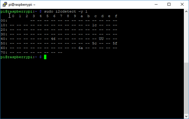

I connected the Sense HAT to the Pi 3 using jumpers. The only pins connected were the 5V, 3.3V, GND, SDA & SCL (the main I2C lines); keeping the EEPROM I2C disconnected. The Pi booted up and the touchscreen on the display HAT worked correctly. I ran i2cdetect to test whether the i2c devices were getting detected, and it showed me that all the addresses were populated. This meant that something was pulling down the SDA pin, so I reconnected the HAT and checked once again.
The screenshot on the right shows the output of i2cdetect: 'UU' is the address reserved for the touchscreen controller, and 0x46 is the address of the ATtiny88. The other devices are environmental sensors & IMU on the Sense HAT, which I won't be using.
I ran the 'Game of Life' code, and the LED matrix lit up (as it should), and the joystick worked fine too.

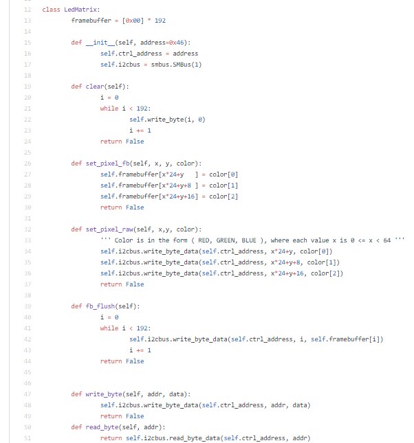

I had a quick look at the Python library to determine the functions that I would need to call in order to control the LED matrix:
To set a pixel, call set_pixel_raw with the x,y coordinates of the the pixel (in the matrix) and the RGB value - that simple!
The function first writes the value of R, then G and B to the ATtiny88 over I2C.

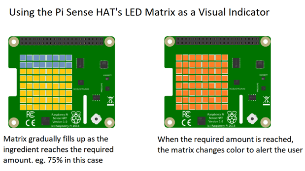

I did two quick tests:
Next on the list:
  • I'll start working on the code that does what I had originally proposed: filling up the matrix on the Sense HAT a pixel at a time. This would work in conjunction with the bar graph on the LCD.
