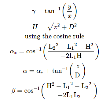

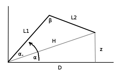

With the servo control out of the way i started planning moving the robot arm. I want to control it via (x,y,z) coordinates so i did some furious scribbling on paper and came up with the following
The following diagram is a side view of the arm with L1 and L2 as the lengths of arm segments.
This next diagram is an overhead view of the arm with D being the distance the arm is extended from the centre point.
And the math:
I wrote a quick script which does this calculation for a desired x,y,z coordinate (as usual its on my github).

    crackedpepper over 8 years ago in reply to genebren +2
    The maths side of the arm control was actually one of the parts I was most excited about. I initially came up with a matricie of trig equations which I didn't want to have to solve so I started again and…
    genebren over 8 years ago +1
    Adrian, Even a little progress is a step in the right direction. Math like that makes my brain hurt. All those math courses have trickled out of my brain through the years. Keep up the good work! Gene

  • crackedpepper
    The maths side of the arm control was actually one of the parts I was most excited about. I initially came up with a matricie of trig equations which I didn't want to have to solve so I started again and got to what I posted. Thanks for the feedback
