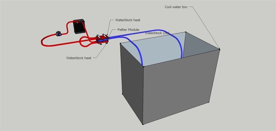

1. General operation
The goal is to have a simple system to operate on a daily basis and to maintain. For this I use a tray in which there is a liquid cooled with Peltier modules through a waterblock. In this liquid, dip copper coils in which the various drinks will circulate, as in a beer printer.

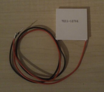

2.2 The Peltier module
"The Peltier effect is a thermoelectric effect consisting of a physical phenomenon of heat displacement in the presence of an electric current. The effect occurs in conductive materials of different natures linked by junctions (contacts). One of the junctions then cools slightly, while the other heats up. This effect was discovered in 1834 by physicist Jean-Charles Peltier."
https://fr.wikipedia.org/wiki/Effet_Peltier

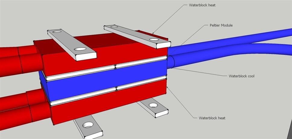

The advantage of these modules is that they are very cumbersome (3mm thick 40X40mm) and easy to use. But it is necessary to cool them properly so that the operation is good and so that the service life is long.
2.3 Waterblock
Water cooling system. Widely used in computers to cool the processor or the graphics card, it has the advantage of a better dissipation capacity than aircooling. In my case I will use one to cool the hot face of the Peltier modules and another to recover by conduction the cold generated by the other side of the Peltier modules.
2.4 Thermal pad
It is positioned between the Peltier module and the waterblock. Is the lens the same as the thermal lug: to ensure good thermal conduction. This one is better with a thermal pad than with the thermal paw. It also has the advantage of not being tacky and having a longer life.

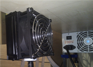

2.5 Ventilated radiator
This is an important element, it allows the evacuation of the heat generated by the Peltier modules. Without radiator the cold generator could not work.

    Justin, Wow! This is coming along very nicely. Are you planning on having the DS18B20 in contact with the waterblock (it was not shown in your drawings)? Do you have a target temperature for the waterblock…

    Thanks for your encouragement! I Planning on having the DS18B20 in contact with hot water and cool water.
