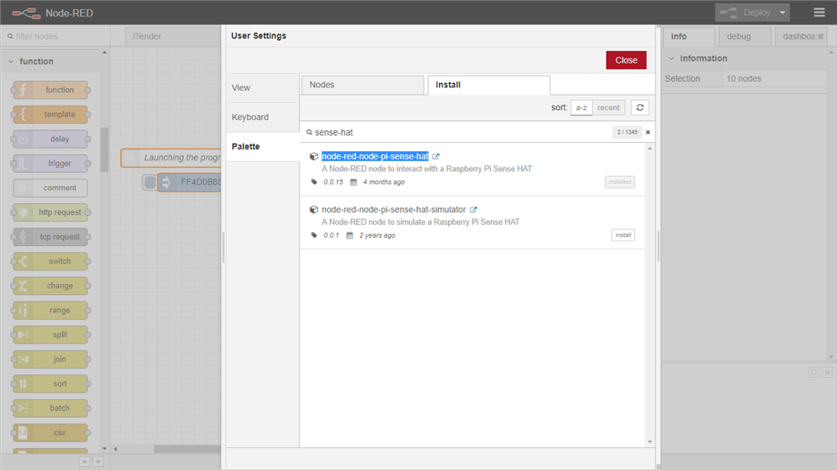

          1.2  Installing node-red-node-pi-sense-hat
https://flows.nodered.org/node/node-red-node-pi-sense-hat

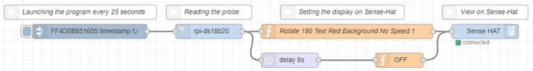

          1.2.  Display the temperature on the LED matrix
For that I realized the following program :

        "id": "f05fddd1.88f6f",
        "type": "function",
        "z": "756ed309.7d647c",
        "name": "Rotate 180 Text Red Background No Speed 1",
        "func": "msg.color = \"red\";\nmsg.background =\"0\" ;\nmsg.speed = \"1\";\nmsg.payload = \"R180\\n\"+msg.payload;\nreturn msg;",

        "id": "13713ce2.a9cfc3",
        "type": "delay",

        "id": "7ad546f5.031758",
        "type": "function",
        "name": "OFF",
        "func": "msg.background = \"off\";\nmsg.colour = \"off\";\nreturn msg;",
        "outputs": 1,

        "id": "7606b20e.1900cc",
        "type": "rpi-ds18b20",

        "id": "7e4fa775.acd498",
        "type": "inject",

        "id": "273ab74b.419948",
        "type": "comment",
        "name": "Launching the program every 25 seconds",
        "info": "",

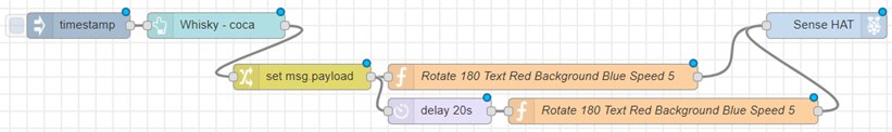

I also did a program that marks the name of the drink when I throw a cocktail.
        "id": "367f95e4.4b636a",
        "type": "inject",

        "id": "118e46b5.d9c299",
        "type": "ui_button",
        "z": "88fe036.c4c23",
        "name": "",
        "group": "82b4dd32.05812",
        "order": 1,
        "width": 0,
        "height": 0,
        "passthru": true,
        "label": "Whisky - coca",
        "color": "",
        "bgcolor": "",
        "icon": "",
        "payload": "0",
        "payloadType": "num",
        "topic": "",
        "x": 500,
        "y": 1560,
        "wires": [
                "9de3ec76.a7563"
        "id": "9de3ec76.a7563",

        "id": "fff8b14.3db765",
        "type": "function",
        "name": "Rotate 180 Text Red Background Blue Speed 5",
        "outputs": 1,

        "id": "28a8ecdf.cd3fa4",
        "type": "delay",
        "name": "",
        "pauseType": "delay",
        "timeout": "20",
        "timeoutUnits": "seconds",
        "rate": "1",

        "id": "9880dafa.7480c8",
        "type": "function",
        "outputs": 1,

        "id": "71f8d9cf.684ee8",
        "type": "rpi-sensehat out",
