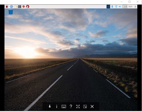

To configure and monitor everything, I will go over the setup I use on the Pi, to get everything up and running well, and provide a nice headless interface to the Pi using VNC.
Feel free to make suggestions on some of the other devices in the kitchen that may be useful.
I have attached a quick run through on getting a Pi set up with Codesys and running headless.  It's lean on detail for now, but for folks who may have done these things before, may be adequate for detail.  I'll add more detail over time, but I wanted to get this out early, so perhaps others can follow along as I go.  Feel free to make suggestions to add steps also for clarity.
