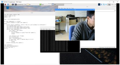

Test USB Camera
For this preliminary step, I will use webcam camera HD Logicool C270 with resolution 1280x720 pixel. Then I use the sample code for live view camera as below,
import numpy as np
import cv2
cap = cv2.VideoCapture(0)
if cap.isOpened() == False:
    print('Connecting camera')
else:
    print('Start Live View')
    cv2.namedWindow('USB Camera');
    cap.set(cv2.CAP_PROP_FRAME_WIDTH,640)
    cap.set(cv2.CAP_PROP_FRAME_HEIGHT,480)
    while( cap.isOpened() ):
        ret,frame = cap.read()
        if ret==False:
            print('Grabbing camera fail')
            break
        cv2.imshow('Live',frame)
        key = cv2.waitKey(5)
        if key==255: key=-1
        if key >= 0:
            break
    print('Closing the camera')
cap.release()
cv2.destroyAllWindows()
quit()
and this is the screenshot of the desktop
Fig.1 Screenshot of Live View using C270 Webcam camera

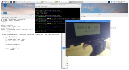

Test Pi Camera
After installing Pi camera provided in the Challenge Kit I copy the code from https://www.pyimagesearch.com/2015/03/30/accessing-the-raspberry-pi-camera-with-opencv-and-python/  as below,
from picamera.array import PiRGBArray
from picamera import PiCamera
import cv2
import time
camera = PiCamera()
camera.resolution = (640, 480)
camera.framerate = 32
rawCapture = PiRGBArray(camera, size=(640, 480))
time.sleep(0.1)
for frame in camera.capture_continuous(rawCapture, format="bgr", use_video_port=True):
     img = frame.array
     cv2.imshow("Live View", img)
     key = cv2.waitKey(1) & 0xFF
     rawCapture.truncate(0)
     if key == ord("q"):
          break
and the screenshot of the camera live view is shown below,
Fig.2 Screenshot of Live View using Pi Camera
