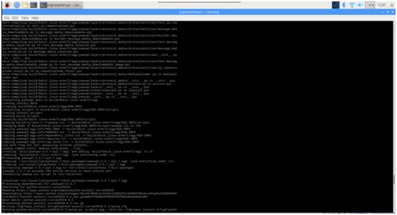

4. Install the yowsup by command
pip install yossup2
The screenshot of the installation process will be like below,
Fig.1 Installation process of yowsup

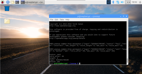

5. After installation finished, we need to request a registration code to our phone number by command,
python yowsup-cli registration --requestcodesms --phone 39xxxxxxxxxx --cc 39 --mcc 222 --mnc 10
6. If the installation success  and request code by SMS is success shown below,
7. After receiving the code, we can send the code for confirming the registration.
python yowsup-cli registration --register xxx-xxx --phone 39xxxxxxxxxx --cc 39
