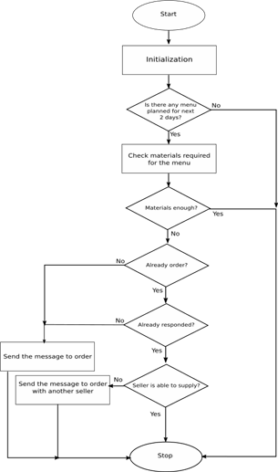

Planning the software flowchart (Program2)
After initialization, before coding all of the programs, I make the flowchart of the organization of the code (I always do it). As mentioned in my previous blog post, there is two program. However, I forget to add the client program for planning the next menu, so that I add the program in our plan and make the flowchart. Below is the flowchart of those 2nd programs since its little complex comparing other 2 programs,
Fig.1 Flowchart for checking the storage and order (Program 2)image

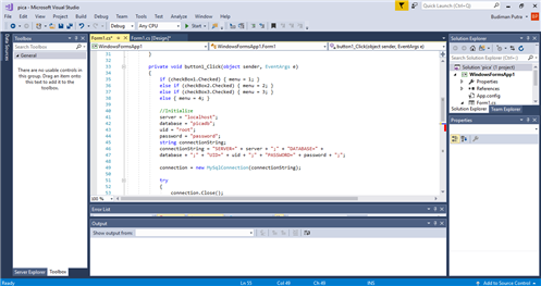

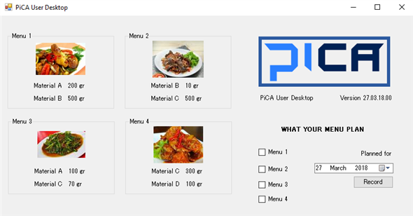

Fig.2 Development process of PiCA User program for planning the next menu
This program is developed using C# .NET. For this stage, I will consider the desktop application only. I will try make the mobile application version if possible. Then for this user program, I make the dummy menu and material for simplicity. Of course, it is absolutely able to be expanded in a real case. I add four menus and four materials. The menu is a combined of four materials with different sizing. This composition has been added to the database initialization.

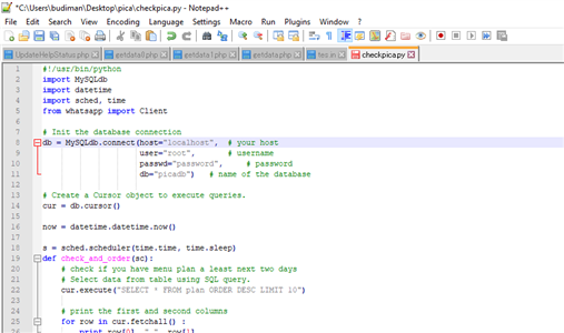

Fig.3 Finishing the Program 2 for checking stock and order to the seller by WA messenger
This program is developed using Python, MySQL, and Yowsupp platform. This software run in every hour to check the planned menu and works in console mode.
