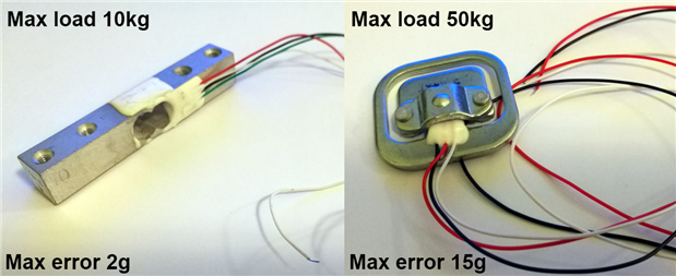

There are two things missing on this model and those are the support legs and the camera mount. There will be three support legs one on each side and one in the middle which will split into two to accommodate both the left and right part. The left part will be supported by 4 50kg load cells (right), while the right part will be supported by two 10kg load cells (left) (This is too much I know, but these are the ones I have at disposal atm, the thing i am looking at is accuracy which will be good for both parts). When it comes to the camera mount it will have a small servo which will swivel the camera around so I can get the view of the whole shelf, I will be using a 50cm extension cable for the camera.

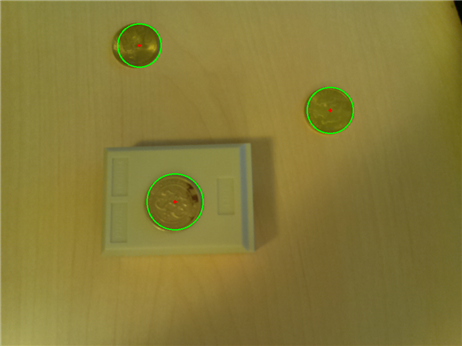

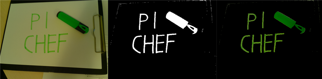

The last thing I did this week and the newest thing by far that I have done is the start of computer vision (OpenCV). I found a lot of great tutorials and books online, and am going slowly to get to know it as best as I can. For now I can do some simple color, line and circle detection. I am trying to go through as much as I can and experiment along the way so I can see what is the best and easiest I can do for the labels later. These are some of the programs I wrote during this week, the first one focuses on color detection (a wide range of the green color), and the other program on circle detection. Here are the images and sample codes:
The codes are the attachments in this blog. Thank you for reading all the way, hope you like the blog!
