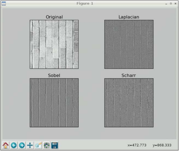

1. High-pass filters
High-pass filters will let high-frequency information like edges to enhance, while restricting low-frequency information. In the picture below is shown the effect of three different high-pass filters in OpenCV with the name of the filter above the picture (the codes for this and the other image will be in the attachment bellow).

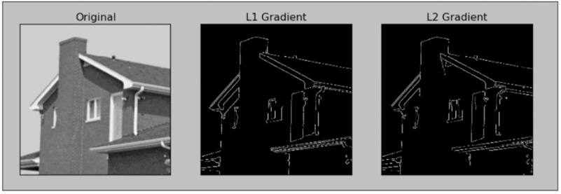

2.Canny Edge Detector
The Canny Edge detector is a edge detection method developed by John Canny.
