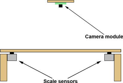

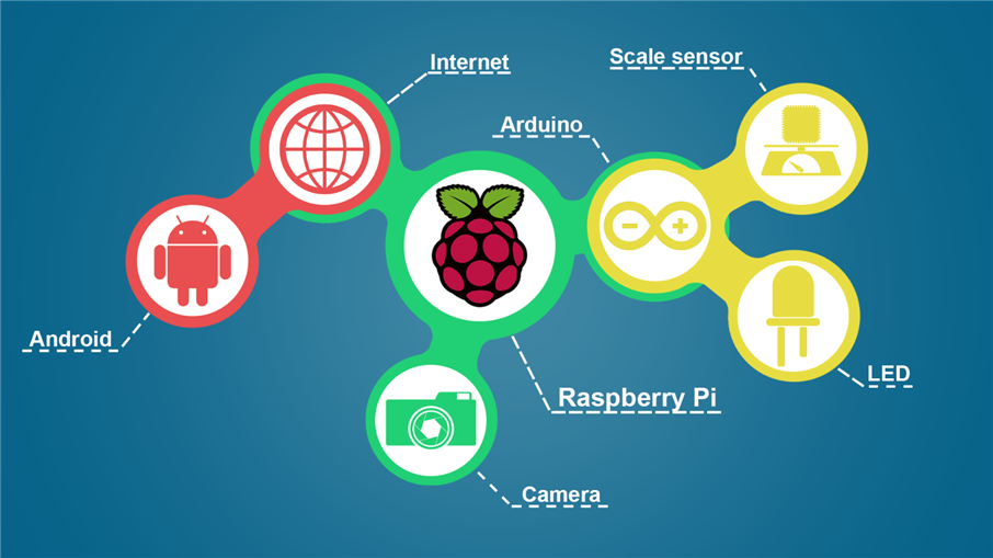

The center of the whole project would be the Raspberry Pi as the central brain which will communicate with the sensors and the internet. The shelf itself will be supported with scale sensors which will keep track of the weight, while a camera module above will monitor what is put on the shelf itself. To identify the different things on the shelf the most likely route for something like that would be either stickers for the packaging or specially designed containers (the progress of the project will determine). The idea of the stickers is to have cheap intuitive stickers of what is what, which would be recognized by the camera module. Of course making a sticker for everything would be impossible so the user will be able to match "blank" stickers to the desired thing using the app (By blank - the stickers will be universal; for example a number a person can read with the symbols around which would help the camera module). The user could print out there whenever he runs out. The other idea is having specially designed containers with some sort of sensor detecting what that is (Strict location for an ingredient for example). How the project and time work out will determine the way that I'll develop the project. The idea is also to make it possible to connect it to other shelves like this and adding other features that could be lights, smoke and temperature sensors, or anything else that would help around the kitchen. If this all goes well, the finishing part would be a heavy duty storage area, which would house vegetables with climate control (temperature, humidity, fresh air).
This is just a fast picture I made, and not close to the final design, I will have 3D models when i finish designing it

  5. Connecting everything (Android-Internet-Raspberry-Arduino-Sensors)

    mcb1 over 8 years ago
    There's been the odd blog here with weight sensing, so you should be able to piggyback off those.
    While I think it's a clever idea, I do share some of the concerns abut how you will single out ingredient x weight.
    You can certainly identify them with labels, but what does container/jar xyz weigh.
    You might want to consider splitting the shelf weighing into two or more areas, each with weighing capability to improve the granuality of the system.
    I'd also check the lead time on your sensors, as you don't want them to cause a delay and wreck your project.
    Even if you don't get it perfect (ie the wrong weight range), it becomes an excellent working prototype and still meets your challenge design.
    The one piece of advice I can give is to make some form of plan, and try to meet the blog requirements.
    it may seem like more work but sharing your progress or where you're stuck can often lead to a suggestion to get you out of that hole/sticking point.
