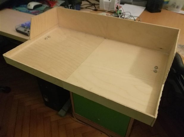

The tenth blog, time really flies. I am super busy during this period at university but finally managed to find time to make the first working prototype. By first working prototype I want to say, a prototype that has the functionality that I wanted in the beginning. At this point, the S.H.E.L.F. registers when something is put on top of it, scans the shelf area with the camera looking for a label, then if the label detection goes through it uploads data online where I can view it on a phone or on a different computer. There will be one more blog after this where I'll have a user friendly code, with comments and all of that, and with some more programming features added. I haven't managed to do it to the scale that I wanted, due to other responsibilities I had in the meantime. So let's jump into the first prototype of S.H.E.L.F. Let's start of with the setup I am using to test it out. I put the sensors on two wooden planks I found laying around and am holding them in place with two simple clamps, which are more than enough for the weights I am testing at the moment. The shelf part is directly connected to the sensors with nuts and bolts. Here is a picture of the setup:

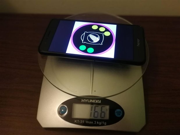

This code is made to write only into the field one which is the main thing I plan on changing, the idea is of course to upload it to corresponding channel depending on the label. This will of course require to have the channels premade and to know which is which, in the same way I stored data on the Raspberry. So now with all of that connected, here is are the results, as I did in the one item shelf blog, for testing i used my phone with a label picture loaded. Firstly here is a picture of the phone's mass measured on a store bought scale:

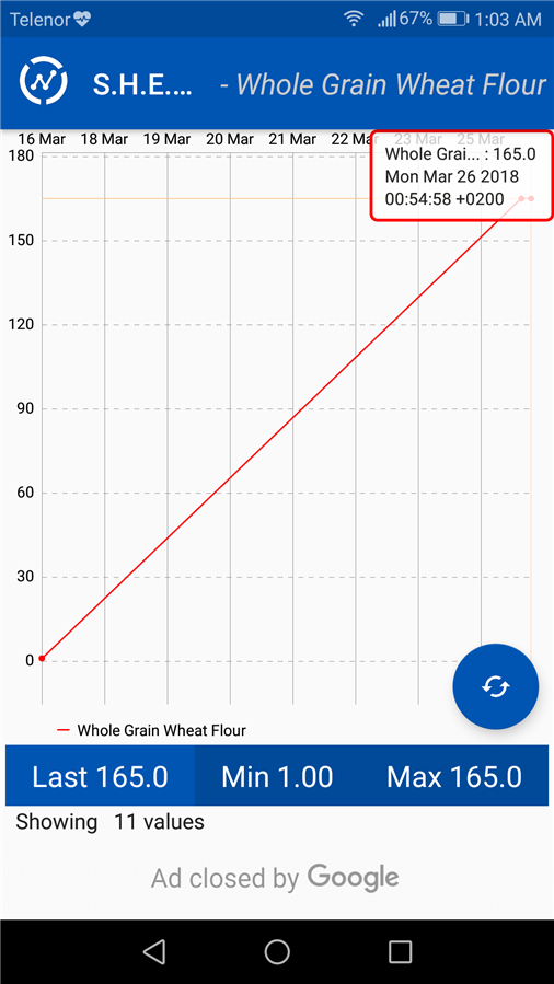

And here is a screenshot of my phone showing what I got when testing out the prototype
And with that I would like this finish up this blog. I am really happy to see all of the parts of the project working together as a whole. This has been a really fun challenge. I will have another blog after this one where I'll do a recap on everything that has been done, can be done and stuff like that, with the use friendly code, step by step guide and the upgrades for this prototype which will make just a tiny bit better. Thanks for reading the whole blog, hope you liked it!
