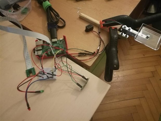

Firs the wire from the sensors to the hx711:
  • The red wire goes to E+
  • The black wire goes to E-
  • The white wire goes to A+
  • The green wire goes to A-
Now for the wires from hx711 to the Raspberry:
  • VCC goes to the 5V pin on the Raspberry - pin number 2 for example
  • GND goes to the ground pin on the Raspberry - pin number 6 for example
  • SCK pin goes to the pin number 31 on the Raspberry (GPIO pin 6)
  • DT pin goes to the pin number 29 on the Raspberry (GPIO pin 5)
The pins for the SCK and DT have to be GPIO pins and they can of course be changed which will of course need the change in the software as well. Here is a picture of the setup I am currently using to test out the load cell with Raspberry:

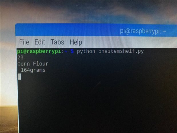

For the preceding code first we import the library, then we set up the pins for the hx711 with hx = HX711(5, 6), these are the number 5 and 6 GPIO pins, the next important thing is the reference unit, on the link of the library in the example.py code there is a great explanation on how to do this, I will just go through some quick lines real fast. The point is to put something of a known mass on to the load cell and then diving the raw data got with the mass of the thing, and that is how we get the reference unit. Next I setup variables val and val1 where val is the current mass while the val1 is the sensor reading from last time, then I check with an if if the mass has changed by 5 grams in my case (I will probably go lower, when I test the load cell a bit more). If the difference in values is greater then we turn on the camera and try reading the label. Just want to point out this is nowhere close to the final algorithm for reading, this is just here to show that everything works together, the final program will also activate the label detection when the load cell readings change, but with a lot of tweaks. With the tests I have done for now I've found that the accuracy of the load cell is within 2 grams of an ordinary kitchen scale, which is great, here is the result I get when I try to read the mass of my phone with a picture of the label on it.

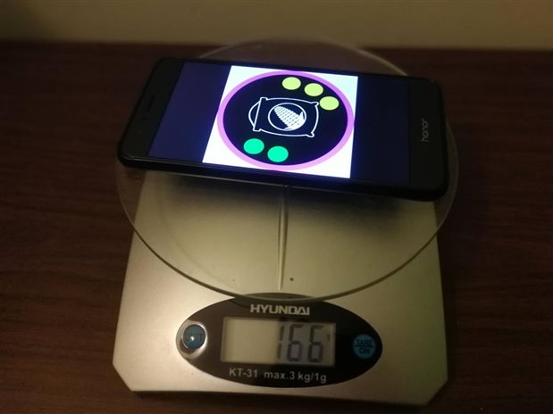

The result is in the 2 gram distance of the kitchen scale value (though I don't know how accurate the kitchen scale is honestly), also on the second picture the problem I stated in the last blog can be seen when the label is on a phone, where the backlight makes the colors too white and harder to read which should be resolved with the use of intended paper labels. I am also planning on adding a feature for easy tweaking when it comes to color detection. The next phases for this project will be uploading the data online, reading it with a phone, getting the last parts for the build of the first full prototype which are more load cells, and making all of that work together. Thanks for reading the whole blog, hope you liked it!
