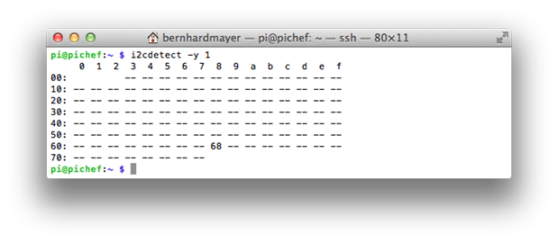

The sensor is connected to the Raspberry Pi via I2C. By default I2C is not enabled on the Raspberry Pi. So you first have to enable it using raspi-config. You find the setting under "Interfacing Options".
After you enabled I2C you can scan the I2C bus with the command i2cdetect -y 1 as on the following screenshot:
Here a device is detected with the address 0x68. This is the grid-eye sensor. So it seems to be working.

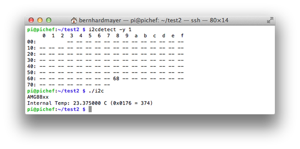

First demo program
Then I wrote a liitle demo programm in C to test and read out the sensor. I am using the libi2c-dev which has to be installed first using the following command:
sudo apt-get install libi2c-dev
The grid-eye sensor has an additional internal temperature sensor (not the sensor array) which I try to read out first as a test. Here is the source code of my program:

The sensor works quite simple. You don't have to start nor set any initialisation registers. It just works out of the box and you can start reading the registers.
Here is a screenshot of the output of the program:
