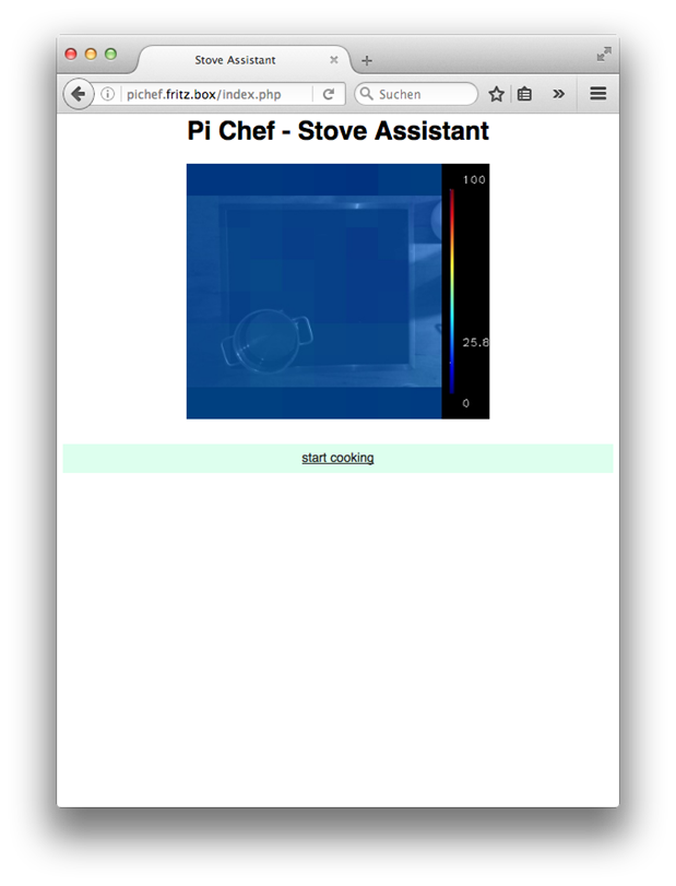

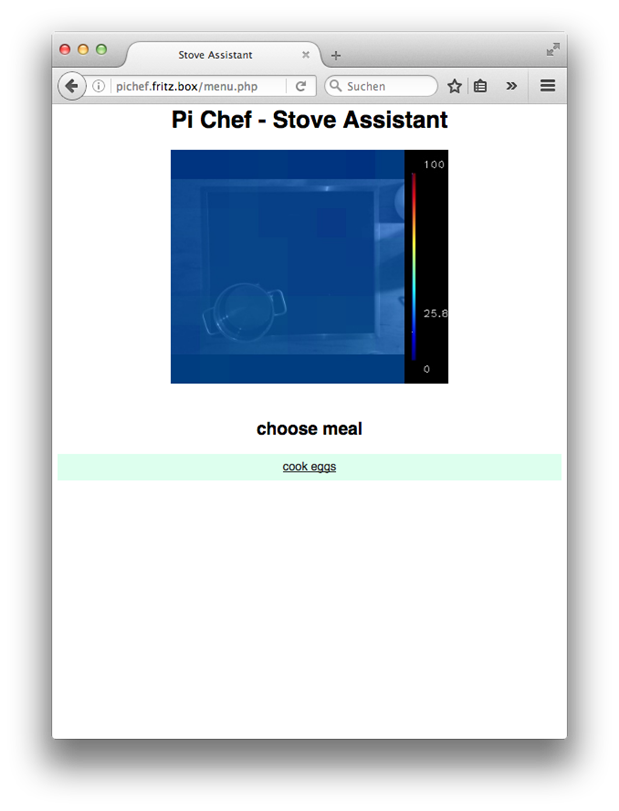

First the user opens the webpage of the stove assistant in his webbrowser.

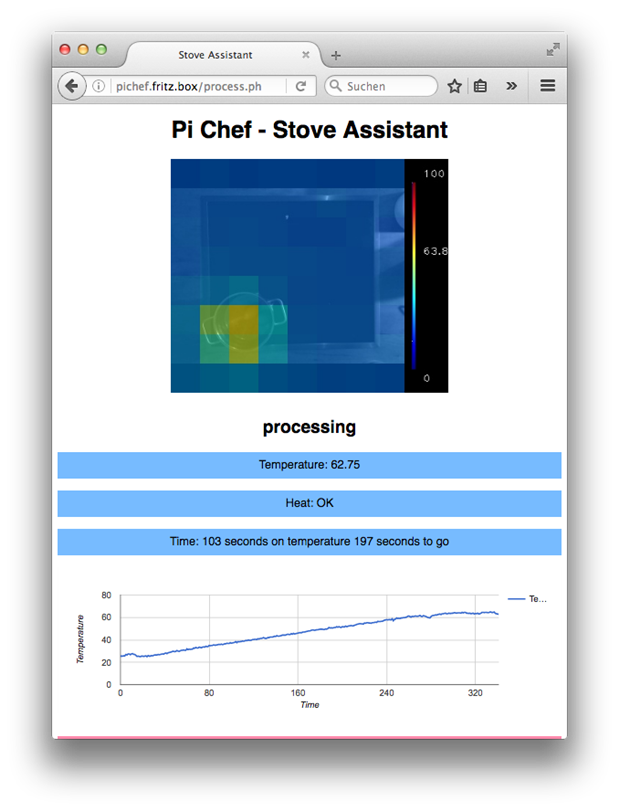

Then he clicks on "start cooking" and comes to the menu with all the meals. At the moment there is only one meal to cook: eggs, but I think this is ok for easter time. The process data is: Temperature: 60 degrees celsius (because of the problems with the temperature measurement by the grid-eye sensor); 300 seconds duration.

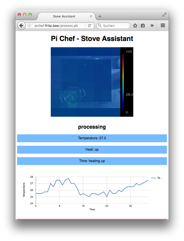

After another click the process starts. At the beginning the temperature is very low and the assistant advices to heat up and that it is in the heating up process. Also the temperature profile graph starts to be drawn.
After a few minutes the cooking temperature is reached and the timer starts to count down.

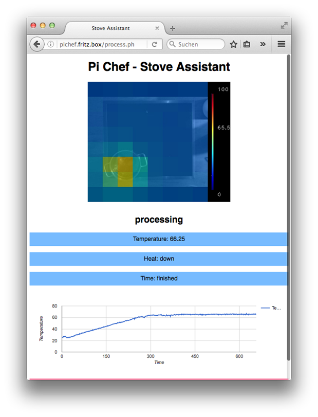

Another few minutes later the timer is at 0 and the eggs are ready cooked. It is also stated on the screen of the stove assistant. Additionally the user can also view the temperature profile. There the bend at about 60 degrees celsius where the timer started is very interesting.

    Nice update on your project. It is interesting to note that your temperature readings stabilized at ~66 degrees.  I would imagine, that if the water was boiling (~100 degrees), then you might be able to calibrate your reading given this information.
