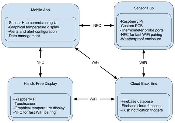

System Architecture:
To satisfy the feature requirements, I propose a system architecture composed of four main components: a Sensor Hub, a Cloud Back End, a Mobile App, and a Hands-Free Display.
Sensor Hub
This device is responsible for monitoring the temperature of the food and sending the data to the Cloud Back End. It will feature a weatherproof enclosure containing a Raspberry Pi and a custom PCB. The PCB will contain a multi-channel ADC and accompanying components to connect to the temperature probes. The Raspberry Pi will run Android Things OS (not Raspbian!), and a custom app will be installed. The Sensor Hub app will communicate with the ADC to acquire temperature samples, and it will upload this data to the Cloud Back End. The NXP NFC board will be used to receive WiFi credentials from and pair with the Mobile App. Once the Sensor Hub and Client App are paired, the devices will exchange data via the Cloud Back End.
Cloud Back End
The Cloud Back End is responsible for storing, distributing, and monitoring data. It will be built using the Firebase platform and will include a database and cloud functions. It will store all temperature data points as well as the user’s alert configuration. Every time a temperature data point is added to the database by the Sensor Hub, a cloud function will run to check it against the alert range, and Firebase Cloud Messages (push notifications) will be triggered as necessary.
Mobile App
The Mobile App is the main interaction point for the user. It will enable the user to monitor the temperature of each sensor connected to the Sensor Hub. The app will communicate with the Cloud Back End to receive temperature information and to configure alerts. When an alert is sent from the Cloud Back End, the Mobile App will receive it and will alert the user with a vibration and sound. The app will be installed on an Android smartphone with cellular data service to enable true mobile temperature monitoring.
Hands-Free Display
A second, always-on display provides a glanceable monitor for the chef. This can be placed in the kitchen so that the chef can quickly see the cooking temperature without touching their phone with messy hands. This device will be a second Raspberry Pi, and it will have the touch screen attached. It will run its own Android app, based on the Mobile App, that is optimized for its use case, and it will connect to and receive data from the Cloud Back End in the same way. This device is meant to be used indoors and will not need to be weatherproof.

    genebren over 8 years ago +1
    Johnathan, Very nice start! I have always wanted a good, remote temperature monitoring system. I have owned a couple of 2-channel, wireless monitors in the past, but these things were flaky. They would…
  • jschools
    jschools over 8 years ago in reply to aspork42
    It would be nice to power the Pis with batteries, and I may do that if I have extra time at the end. It would take more engineering time and materials than simply plugging in a wall adapter, so I decided to spend my time on the components that are more interesting.
    Temperature control was definitely on my mind as I was planning this, and that may be a project on its own in the future. I'm not much of a mechanical engineer, and I don't have the tools to fabricate parts that can withstand a lot of heat. (Wood or 3D-printed plastic probably wouldn't survive being in contact with hot metal for 12 hours   )
  • e14phil
    e14phil over 8 years ago
    Exciting, I can't wait to see more.
  • aspork42
    aspork42 over 8 years ago
    Nice idea!
    Will the sensor hub be battery powered?
    Have you considered provisions to do closed loop control like opening vents?
    Johnathan,
    Very nice start!  I have always wanted a good, remote temperature monitoring system.  I have owned a couple of 2-channel, wireless monitors in the past, but these things were flaky.  They would work one week and then fail the next.  I was part of a three person competition grilling team and we would run between 4 to 6 cookers through the night and early morning.  Being able to stay warm and monitor the temps was a good feature, but when they failed you back out in the cold checking them manually.
    Good luck on your project and keep up the good work.
