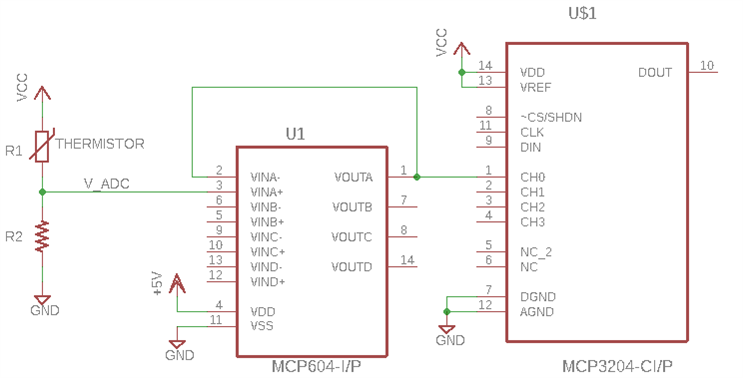

Designing the Schematic
I started the schematic with the voltage divider I had previously designed. I then designed a voltage follower using an operational amplifier and hooked them together. This output is then fed into the ADC, and I added power supplies and grounds where appropriate.
Figure 1. Schematic of voltage divider, op-amp, and ADC.

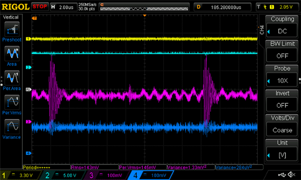

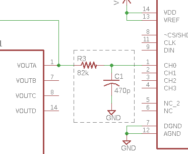

During my earlier prototyping phase, I noticed a lot of noise in this circuit and found that some of the noise could be reduced by averaging in software. I wanted to reduce this noise even further in hardware, so I did some research on RC filters and ADCs. I found a helpful article that explained how the internals of an ADC work and how to design a filter to smooth out the high-frequency signals that were affecting my data. I used an oscilloscope to observe the noise and to measure the frequencies that were present. It looked like the signal had some considerable noise in the range of 75kHz.
Figure 2. Screenshot of oscilloscope showing noisy input.

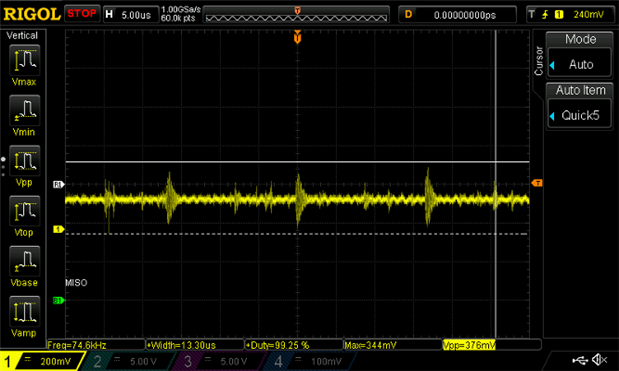

Using this information, I designed a passive RC filter using this helpful website. I found a combination of resistor and capacitor that should reduce the noise in the 75kHz range by about 25dB. Testing the prototype, I found that my filter had a great effect!
Figure 3. Screenshot of oscilloscope showing the noisy input (magenta) and filtered input (dark blue).
Here’s what my schematic looked like after adding the RC filter.
Figure 4. Schematic detailing the added RC filter.

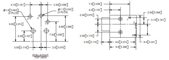

Creating a New Part
Because EAGLE separates the board schematic from the board layout, it similarly separates parts into two related domains: the “symbol” and the “package”. The symbol is used on the schematic, and the package is what appears on the board layout. To create a new part, you need to design both. Fortunately, an EAGLE library already had a headphone jack that was similar to the part I had purchased, so I was able to copy its symbol into my new part. That left only the package to design. I used the data sheet from Digi-Key to design the mechanical specifications, such as the placement of drilled holes, solder pads, and the silkscreen-printed outline of the part.
Figure 5. Mechanical drawing from the datasheet of the headphone jack.
The mechanical drawing was not consistent about the orientation of the part, so I had to be careful to interpret the drills drawing (Figure 5 above, left) as a top-down view and the dimensions drawing (above, right) as a bottom-up view.
Figure 6. The headphone jack package I created.

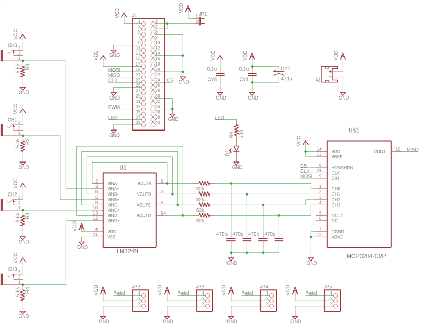

After creating my part, I swapped it in for the thermistor in my schematic. At this point, I had one completed channel. My Sensor Hub PCB is going to host four channels, so I copied the single channel three more times and connected everything up. I then added the header pins that would connect to the Raspberry Pi and wired up the ADC and power. I added some more header pins to connect the servo to power, ground, and the Pi’s PWM pin, and I also added a few bypass capacitors.
Now that my schematic satisfied my functional requirements, I took some time to consider any other helpful features that I might want. I realized that the servo was using the Raspberry Pi’s 5-volt power supply, but that may not provide enough current if I find that I need additional servos or more powerful ones. In this case, I would want to have an external power supply to power the servos. I decided to add a 5V power supply jack to my board and a pair of jumper pins so that I can choose whether to connect the servo power supply to the Pi’s supply pins or isolate it with its own external one. I also decided that an LED would be a good addition so that I could have some kind of status indicator to tell me if the Pi lost its internet connection.
Figure 7. Final schematic for my Sensor Hub including bonus features.

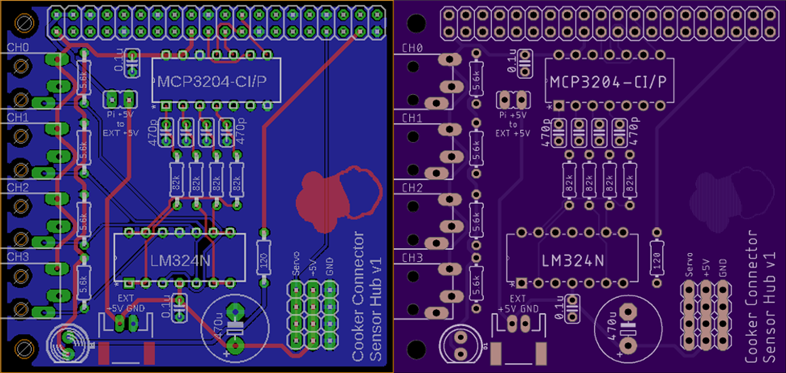

Board layout
Now that the schematic was done, I switched over to board layout mode in EAGLE. I want my board to attach to the top of the Raspberry Pi, so I used the mechanical drawings to determine where to place the header pins and holes so that they would line up with those of the Pi. I decided to include only two of the mounting holes on my board, so that I could trim off some board area. Fabrication services usually charge by the square inch, so by trimming off about a quarter inch, I saved a few bucks. The header pins should provide more than enough strength on that side of the board, so I’m not worried about losing the additional contact points.
After defining the fixed locations and edges of the board, I started placing the input jacks. They obviously needed to be along one side of the board with enough clearance around them to accommodate the thermistor probe plugs. Next, I positioned the external power supply jack on another edge, and then put the rest of the components on the board.
Figure 8. Initial board layout with arbitrarily-placed parts and air wires.
The fun part was next: fine-tuning the placement of the components and routing all of the wires. EAGLE draws “air wires” between all of the connections that need to be made. These are a tangled “rat’s nest” of overlapping lines to begin with, and as you complete a connection from one end of a line to the other, it disappears. Once all the air wires are gone, you know that you are done. EAGLE also has an auto-router feature that will attempt to draw all of the wires for you. It usually does a good job and only takes a few seconds to run, but I get a huge amount of joy and satisfaction from drawing wires myself. You can also choose to route some portions manually and have the auto-router do the rest for you. This is particularly useful if you have some sensitive signals, such as analog inputs, that you want to keep far from noisy signals, such as PWM or serial lines.

After spending far too long on this, I finally got the image imported and sized properly. I initially thought it would look neat as part of the silk-screen layer, but I think it looks way cooler if I move it to the top copper layer, so that the logo is actually etched into the copper and covered by the solder mask. It’s nice and subtle, and it looks good on the preview render.
Figure 9. Final PCB layout (left) and OSH Park preview rendering (right).

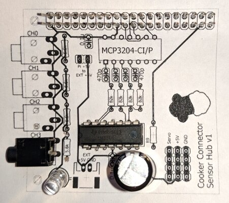

I gave the PCB layout one final look-over before ordering. It would be really disappointing to buy and wait for a board that has a flaw of some kind. For extra peace of mind, I test-fit the size and placement of the components by printing out the layout on a piece of paper and punching holes in it where they would be drilled. I was especially concerned about the dimensions of the custom part I made, but it turned out to be just right.
Figure 10. Test-fitting some components using a paper printout.
Over all, it’s going to cost me about $25 for a shipment of three copies of my board. OSH Park claims the boards will be ready in about 14 days, and I’m really excited to see how they turn out!

    jschools over 8 years ago in reply to genebren +2
    Thanks Gene. I'm expecting to need up to three servos. I added a fourth set of pins just because I had extra space. They all share the same PWM signal because I intend to move them all at the same time…
    genebren over 8 years ago in reply to jschools +1
    Hi Jonathan, There are some chips, like the PCA9635 from NXP, that can provide multiple PWM signals. This device uses I2C (available on RPi) to create up to 8 PWM signals. Using something like this, you…
    Hi Jonathan,
    There are some chips, like the PCA9635 from NXP, that can provide multiple PWM signals.  This device uses I2C (available on RPi) to create up to 8 PWM signals.  Using something like this, you could control each servo independently.  It is a little late to change this, with a board on the way, but maybe on a future version?  RPi does have two PWM channels and I do think that there are some libraries that you could use to convert GPIO outputs to lower precision PWM signals.
    Gene
  • jschools
    Thanks Gene. I'm expecting to need up to three servos. I added a fourth set of pins just because I had extra space. They all share the same PWM signal because I intend to move them all at the same time to the same position. I'm not sure what I could use to determine when and how to control each vent independently. Maybe it would be nice to be able to calibrate each separately, but that can be done mechanically, I think.
    Jonathan,
    Great update on your project! Very clear and methodical. I was a little confused as to why you would put 4 headers for servos and have them all feed off the same PWM signal, running them in parallel?  I will have to try OSH Park sometime.  I have friends that swear by it.
    Keep up the good work, I can almost smell the sweet scents of BBQ from here.
    Gene
