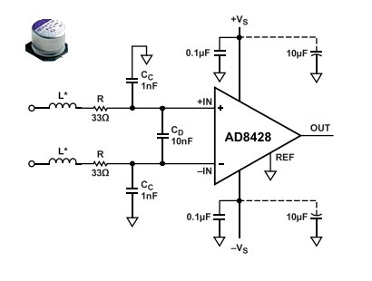

Therefor, low noise, fix gain instrument amplifier AD8424 shall be used in this experiment.Works include scheme design, simulate, PCB design and sold  compononts.
With low ESR, the performance of polymer capacitor shall be tested and verified.
2. Priciples and Diagram
2.1  Low noise, fix gain instrument amplifier AD8424 shall be used. According to the datasheet, there are two basic circuits need good quality capacitor.
- The stable DC power supply need one 0.1µF capacity for high frequency filter and one 10µF capacitor for lower frequency in both Vs+ and Vs-.
- Differential Input  +IN and -IN need low pass filter to remove input distortion and noise. 1nF and 10nF capacitor shall be used for this purpose.
2.2 Polymer Capacitor
In this challenge Kit, Polymer Aluminum Capacitor, 10 µF, 6.3 V, SP-Cap, CD Series is available
I would try to procure rest capacitor from market, including
0.1µF x2
10nF x1
  1nf  x2
After some research on the market, the polymer capacitor lower than 1µF  is hard to find. So I have to replace them with some MLCC.

    fyaocn over 7 years ago in reply to michaelkellett
    That is mainly what I have proposed in my original Application. I notice several problems afterward.
    I would find out more in the experiment. If wrong, I would admit it.
    The polymer capacitor has limitations and sometimes the ESR meter as well. eg. 1F supercapacitor can not get reading which is within the rating.
    Thanks for your suggestion, which is good clues for my experiment. Some math work is required if want to find out the answer.
    Only that I have just got the kits, only two weeks left. Let me try to find  out what happens.

    michaelkellett over 7 years ago
    The feature of polymer caps is usually low ESR. The use of two caps on power supply decoupling (which is not universally recommended) is often
    based on the idea that small cap provides a low ESR but that the large capacitor (the 10uF in your case) should have a fairly high ESR (0.5ohms or more).
    How will you compare the performance of the polymer cap compared with a standard aluminum electrolytic, tantalum or ceramic in your circuit ?
    The small value caps would normally be MLCC or plastic film - MLCC caps should be used with caution in filter circuits, COG or NPO dielectrics are preferred.
    Other materials have significant voltage/capacity sensitivity and can introduce large amounts of signal distortion in some filter applications.
