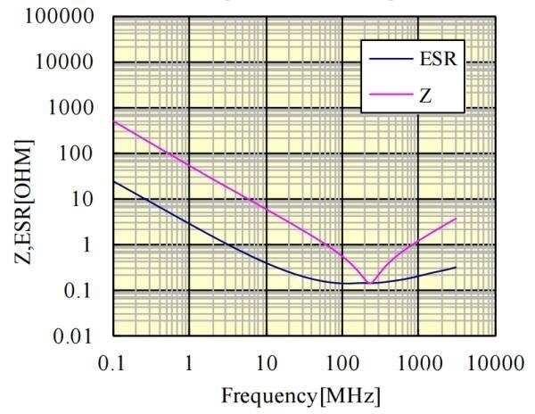

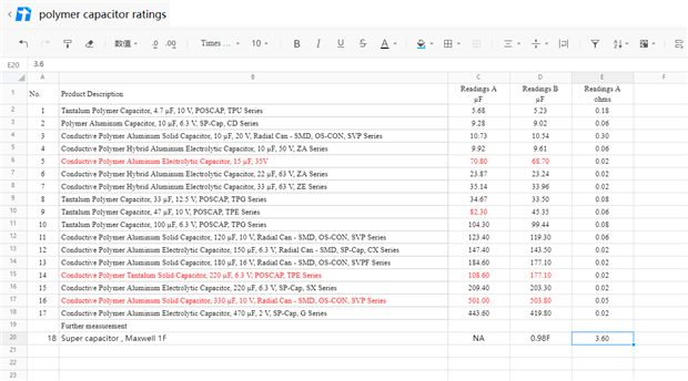

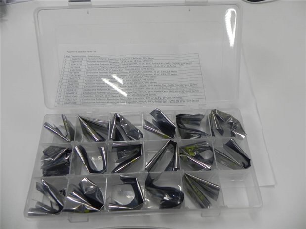

01. Rating and Parameters of Polymer Capacitor in the Kits.

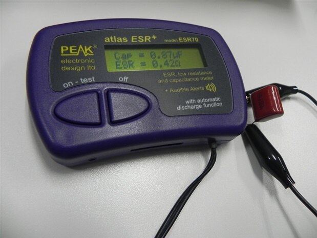

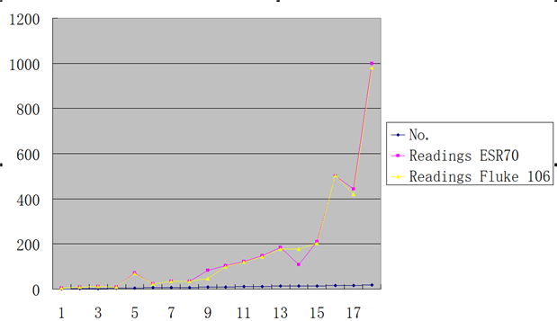

First, all the capacitor shall be measured, capacitor measurement with Fluke 106 as comparation. There are some errors with RED text label, it is not clear what the reasons are. Later, I shall figure it out.
Reading A is measured with ESR70 -  ESR Meter, Reading B is measured with Fluke 106 multimeter.

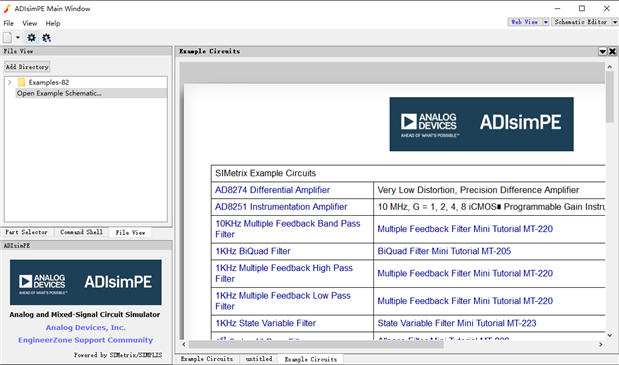

02. Simulation of AD8428 Instrumentation Amplifier by ADI

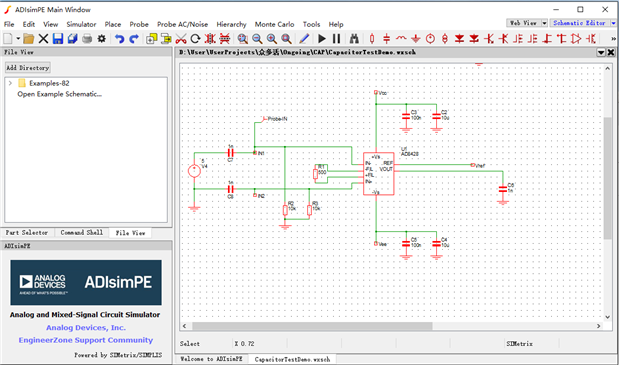

2.1 Simulation with ADIsim
ADIsim is fairly good simulation tools with ample choice and easy configuration.  But I can not get expected results when AD8428  is included in the schemetic.
The Instrumentation Amplifier AD8428 is new product, and not included in the out-of-factory library. AD8428 can be imported as third-party lib with officiall SPICE file. It fails again and again. That is not big deal if there is free time to research. SPICE file is in TXT format. But that part have to be saved for later.

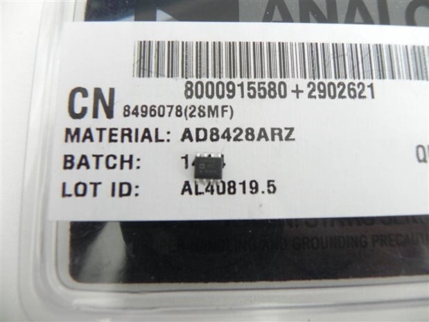

AD8428 Free sample supplied by ADI

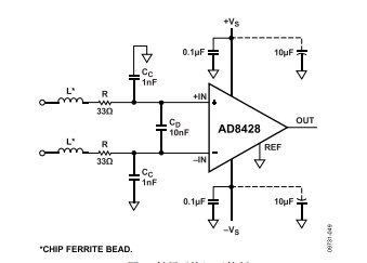

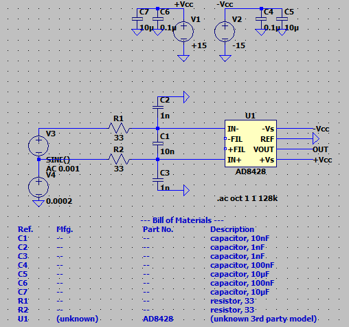

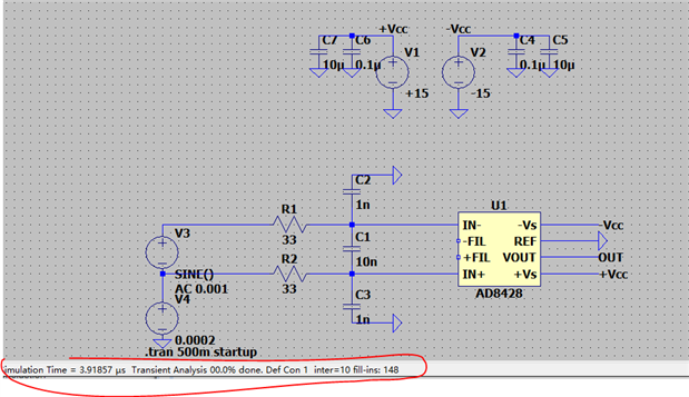

According to official manual of AD8428, the following reference design shall be applied.

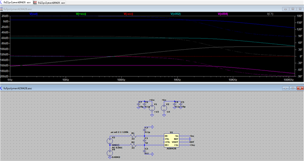

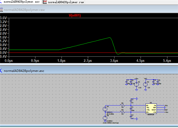

The schematic in LTspice shall be as follows ,then Run the simulation,
The transient simulation results shall be,
with BOM listed below.

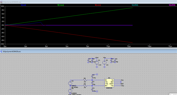

But, such experimental schematic is serious flawed. Since most of the capacitor used in this design  shall be MLCC. The polymer capacitor is much large in size, with minimum of 2.2uF. The feature of polymer capacitor can not be tested.
2.2.2 Now, the best choice is to use as many as possible the polymer capacitor in this design. The performance of Amplifier may not be best in the design, but the operation of amlifier and capacitor can be fully studied first.

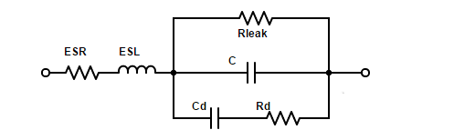

Here is equivalent diagram for capacitor
In most cases,ESL Rleak, Cd and Rd is small enough not to considered. Here is the demonstration diagram shows the Frequency vs Z or ESR.

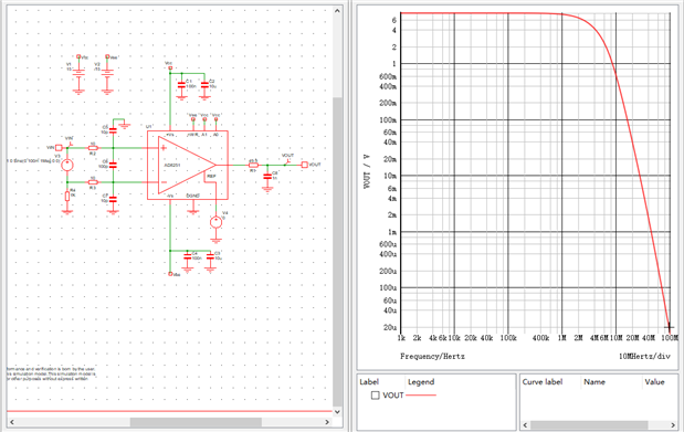

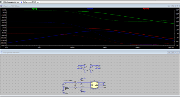

Then update above design with more polymer capacitors  used for filering and bypass.
2.2.3 Updated Design with Polymer Capacitor as follows,

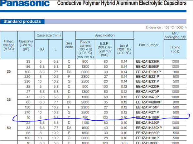

both C5 and C7 shall be 10uF ,Conductive Polymer Aluminum Solid Capacitor, 10 µF, 20 V, Radial Can - SMD, OS-CON, SVP Series

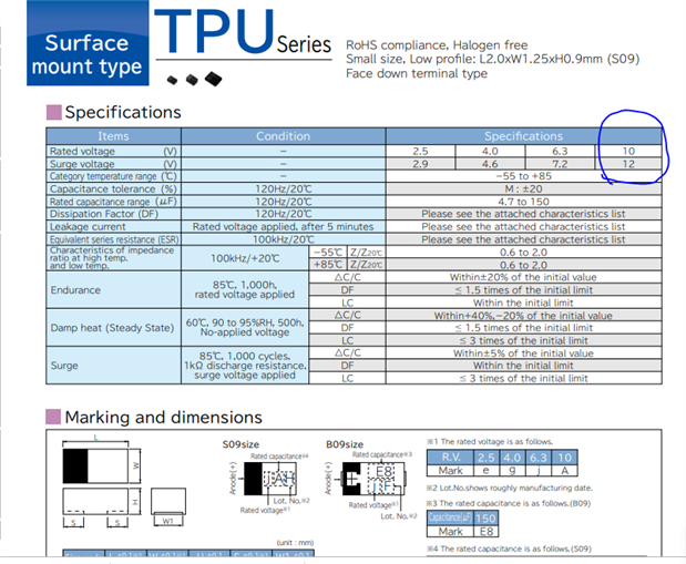

both C2 and C3 shall be 4.7uF ,Tantalum Polymer Capacitor, 4.7 µF, 10 V, POSCAP, TPU Series,
C1 shall be MLCC since AC is applied, polarized capacitor can not work right. With only 4.7uF at hand, but it shall be 10x times of C2 and C3. This can only be experimental setting in this case.
C4 and C6 shall be 0.1uF MLCC, since the the polymer capacitor can not be as small as 0.1uF. While 0.1 uF is needed for high-frequency filtering near IC pins.

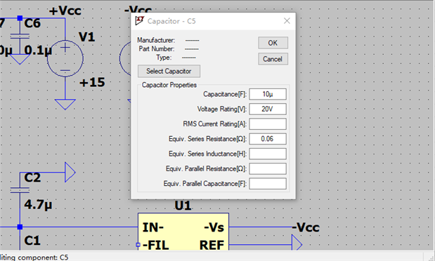

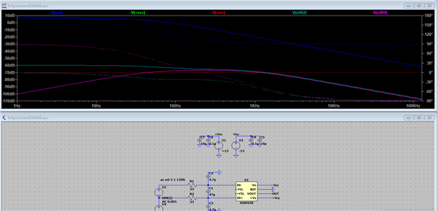

Here is the simulation result.
In this simulation, ESR is filled in the parameters of the capacitors.
Other simulation like transient simulation and AC sweep analysis can be done with different capacitor ratings. That is really fun and useful. Many wrong idea can be tested before burning the chips.
There is not enough time to explain them all, part of the results shown below.

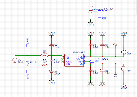

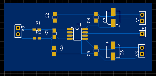

After simulation, design the PCB

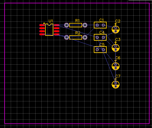

03. Schemtic Design and PCB Design

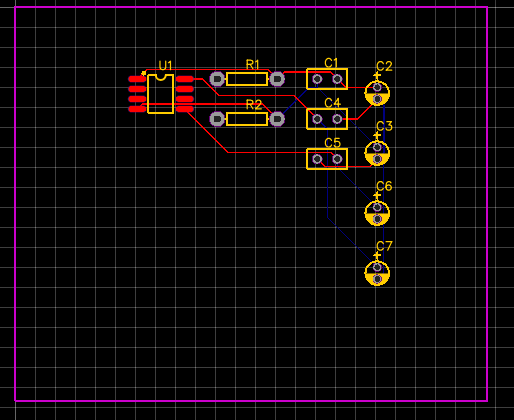

3.1 There have been many EDA tools. CADSTAR is what I used most. While for simple schematic like this, some online web IDE is enough. https://easyeda.com/  is good for this case. That is fairly easy to use even for beginners.
Let start in easy steps with automatic routing and designing,
Schematic design
Generated PCB automatically,
Auto-routing,

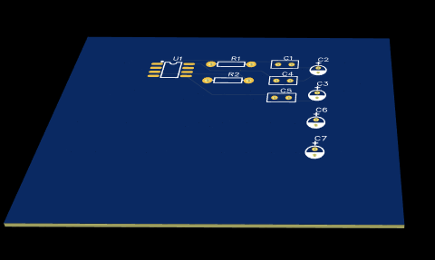

3D view of generated PCB board,
It is obvious that it is not good design. More adjustment shall be made.

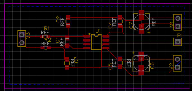

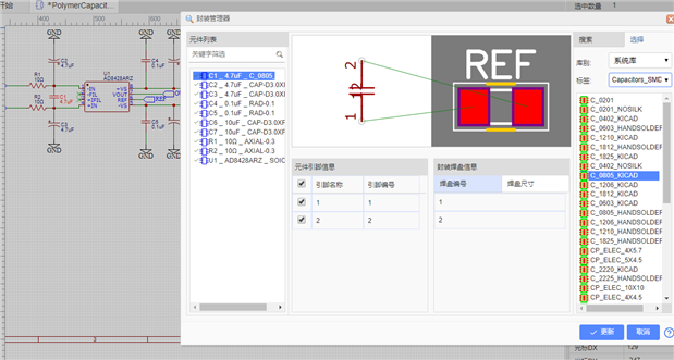

3.2 Updated design with Adjusted Position, Package, then auto-routine with the following results,
Update the package according to Datasheet,

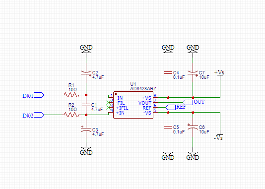

Finally, the Schematic diagram,
Auto-routine after manually adjustment, the Blue wire is on bottom layer

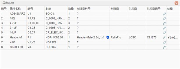

Last step, Output the BOM, and Print the PCB design for PCB making.

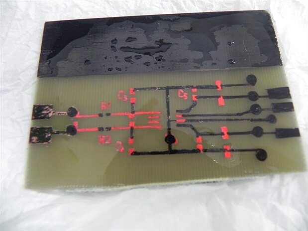

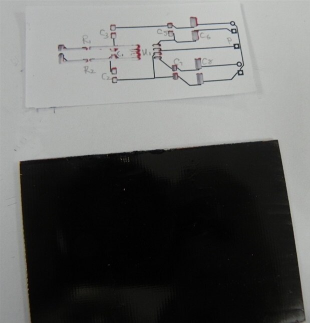

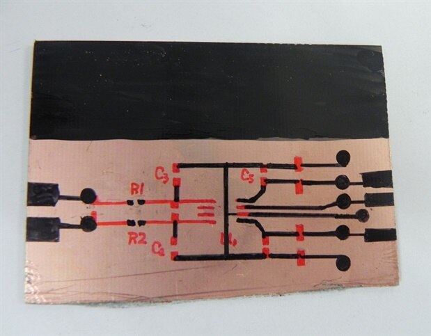

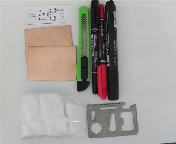

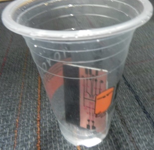

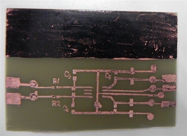

I shall use the easiest way to do and make quick PCB. What I need is only one Oil-paint maker and PCB Copper Corrosive, Sodium persulfate. in that, Na2S2O8+Cu=Na2SO4+CuSO4
Fairly simple in steps One, Two, Three.

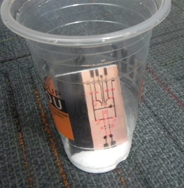

First, Draw the schematic diagram on the Copper Clad Laminate, patient and accuration is needed when there is SMD parts. Use your imagination as you can. To save time, I paint one layer black totally, that is ground layer in the design. I will use fly wire in this case.
.imageimage

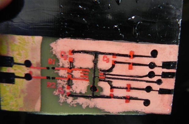

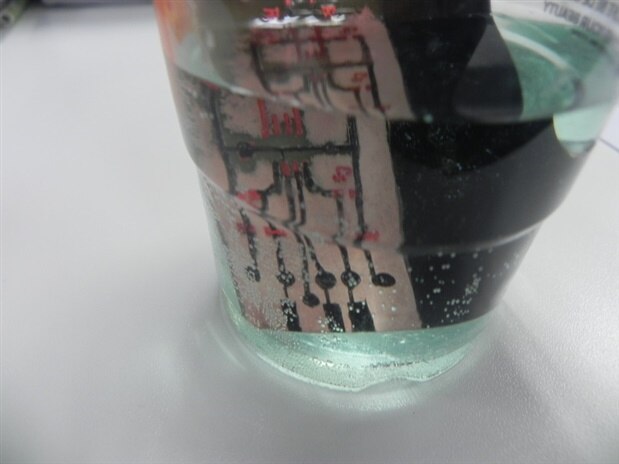

Second, dip the CCL in one bottle with Sodium persulfate solution.  Normally it takes 10 minutes, thirty minutes is OK if paint well and water-proof for copper clad layer
Third and the last, clean the board and remove the paint. That is easy, use anything you can remove grease.

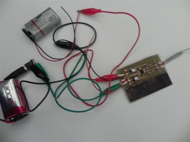

Well, next steps for hand solding.

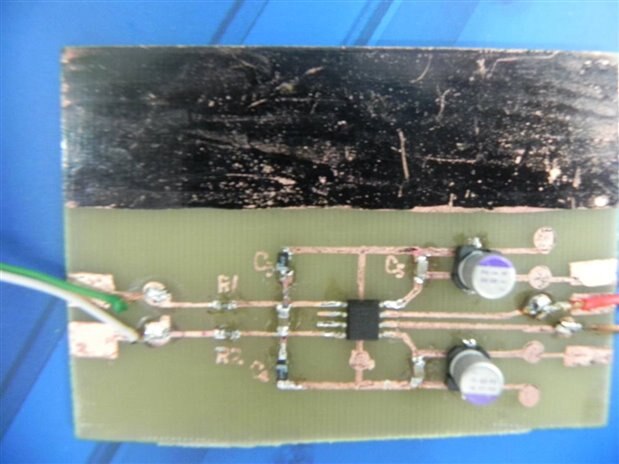

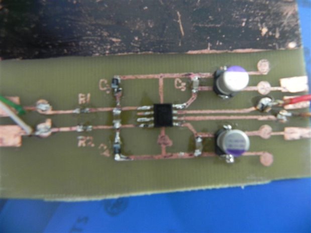

4.2 Solding
There would take not much time, but the polarity of polymer capacitor shall be verified.
Visual check for soldering point is neccesary. Look closer, C2 in the PCB is not well positioned. But the AD8428 is right in position.
4.3 Now the design and PCB making is completed. In fact, most of the work can be outsourced. Send the design and BOM to manufacture via e-mail, they can quote price including solding common resistor and capacitors , you can add important part like amplifier when receiving the board. That would be in much higher standard, but you must make sure the circuit is good.
Manually do all the work alone take more time, but you can correct your mistake very soon. Creating one new PCB will take only one more hour. Poor in quality, but good for experiment.

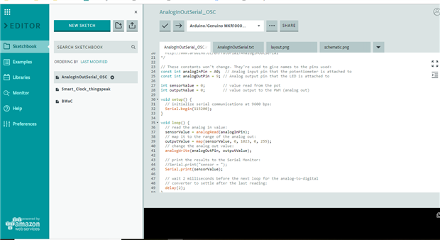

5.1 In my proposed experiment plan, I would use Arduino MKR 1000 to receiving signals in ADC channel and send reading back to cloud. Here is basic sketch tested with Arduino Web Editor
Reads an analog input pin, maps the result to a range from 0 to 255 and prints the results to the Serial Monitor. The circuit:the analog pin A0 as input ranging 0~+3.3V.
const int analogInPin = A0;  // Analog input pin that the potentiometer is attached to
const int analogOutPin = 9; // Analog output pin that the LED is attached to
int sensorValue = 0;        // value read from the pot
int outputValue = 0;        // value output to the PWM (analog out)

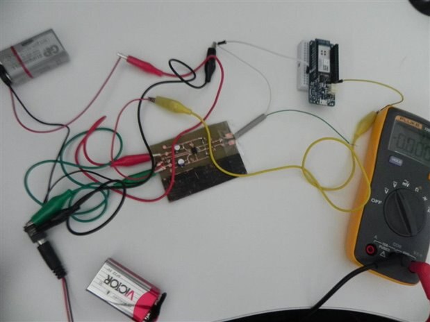

5.2  Power up the board and take on the experiment

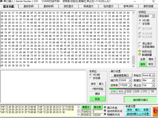

Wiring the MKR1000 board and Demo Board , A0 and GND in MKR1000 vs OUTPUT and GND. IN01 and IN02 shall connect round metal pad attached to chest. Powered with 2x9V battery.
Then plug the Desktop USB ti MKR, and one Serial Port software Serial Hunter,rating 115200-N-8-1.
Now the data flush into the screen in 1kHz sample rate. Since the ECG signal frequency ranging 0.1Hz- 200Hz, such sample freqency is OK for demo purpose.
All data can be saved in .txt format for further research.

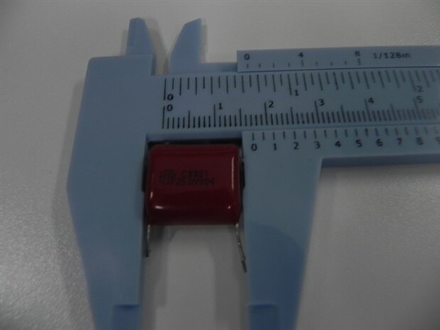

6.2 The features of compact size and large rating.
That is fairly obviously. The following photo tells more than I can describe.

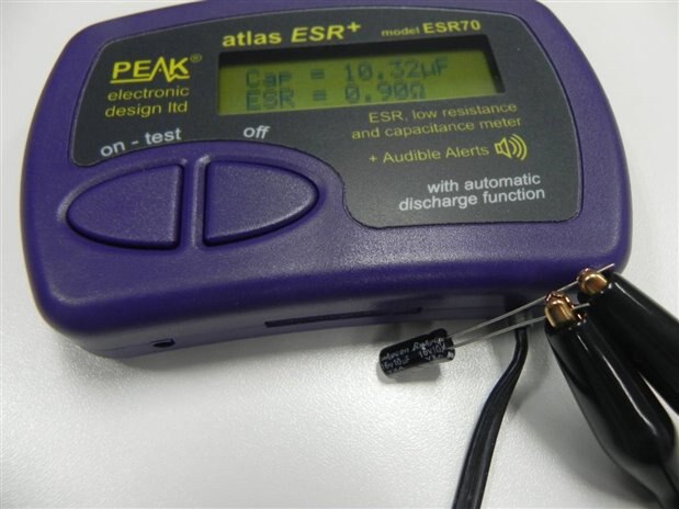

6.3 Small ESR
That is evident too, here is the AL electrolytic capacitor with ESR of 0.9ohm, but for same size the polymer capacitor is 0.30ohm.
As with supercapacitor with much larger size, the ESR is as high as 3.60ohm in 1.0F.
6.4 Measurement Bias and errors
The reading from fluke 106 normally less than ESR70,
Conductive Polymer Tantalum Solid Capacitor, 220 µF and Tantalum Polymer Capacitor, 47 µF, the bias is too much. That is one problems pending for further research.
The measuring of capacitor is not easy, for ESR , more difficult. This ESR reading is not DC resistance, it works only on low freqency AC, around 100kHz AC. Therefore, the ESR reading shall be adjusted if used in High frequency range.

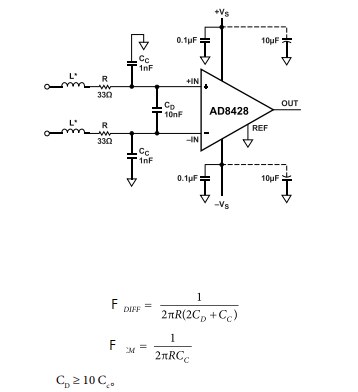

6.7 Special feature on Instrument Amplifier AD8428
AD8428 is in three amplifier configuration.
The CD and Cc work in different ways. CD works as different mode filter, and Cc works as common mode filter. The resonance frequency shall be calculated as formulor below,
But larger capacity can reduce the value of Bandwidth x Gain. The band-width of amplifier will be reduced.
Therefore, the application scope and features of input signal shall be researched before design and selecting electronic components.

  • michaelkellett
    michaelkellett over 7 years ago +2
    You might like to consider what useful purpose C1 has in this circuit and with the values you have chosen for C1, C2 and C3 and R1 and R2. Because C2 and C3 are both connected to ground their series value…
  • fyaocn
    fyaocn over 7 years ago in reply to michaelkellett +1
    That is right. For this cap,ESR is 0.18ohm. The selection of C1 and R2, R3 is interesting. Some calculation shall be done in advance and Simulation gives interesting results as well. This is experiment…
  • fyaocn
    That is right.
    Some calculation shall be done in advance and Simulation gives interesting results as well. This is experiment on polymer capacitor. That  means amplifier could not be main subject for now.  And I have only 15 days to go before deadline, with a little delay on delivery. There are some flaws in my origin design, try to make it rIght now.
  • michaelkellett
    Because C2 and C3 are both connected to ground their series value shunts C1 - so why not remove C1 completely and increase the value of C2 and C3 to keep the impedances the same.
    Alternatively increase R1 and R2 and keep C2 and C3 = 4.7uF to keep the filter response the same.
    Now you can do your test without using a huge MLCC.
    I must point out that this is not a rational way to test these capacitors - the 4.7uF POSCAPs have  a claimed ESR of 0.3R and you have series resistors in your design of 10R -
    so a change in cap ESR of 100% will make a difference of about 3% to the cut off frequency of the filter, but the tolerance on capacitor value is 20% and will swamp this small  effect.
    MK
