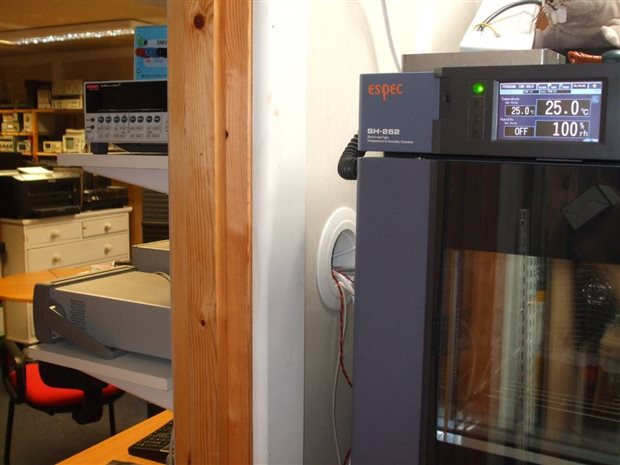

I set up my own test arrangement using and Espec SH262 Benchtop Temperature and Humidity chamber to control the temperature of the capacitors and a Keysight 34972A34972A Data Acquisition system to do the leakage current measurements.
A TTi PL-155-P power supply was used to supply the bias voltage.
Each capacitor was connected in series with a 1000R metal film resistor and the 34972A34972A, on the 10mV range, was used to measure the voltage across the resistor from which the current can be determined. A set of 8 measurements was taken every 20 seconds. The whole setup was controlled by a PC via Ethernet.

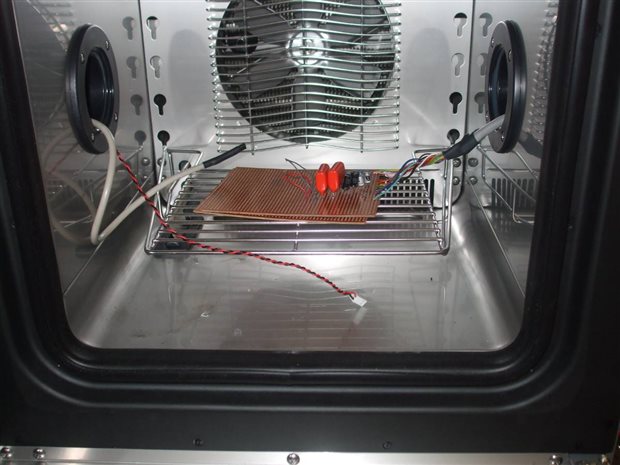

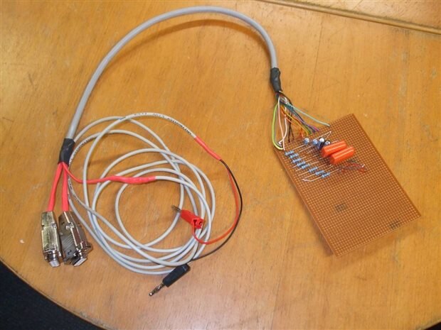

The test board looks like this:
And in the test chamber:

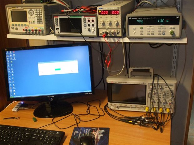

I wrote a programme in VB6 to control the instruments and talk to the test chamber. The computer  and the instruments live inside my nice insulated room but the chamber lives outside because it's a little noisy but also generates a lot of heat when cooling rapidly.
This is my setup for testing things over temperature:
And this is how I keep the noise and heat from the temperature cycler at bay:

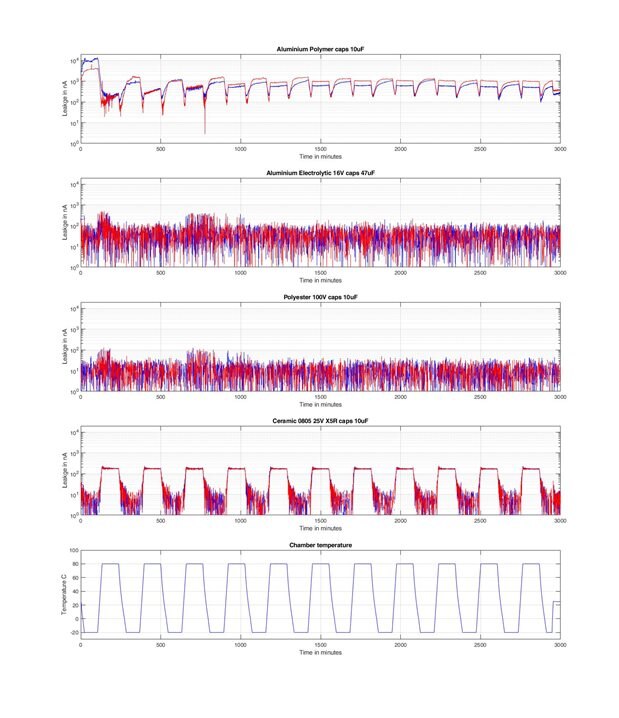

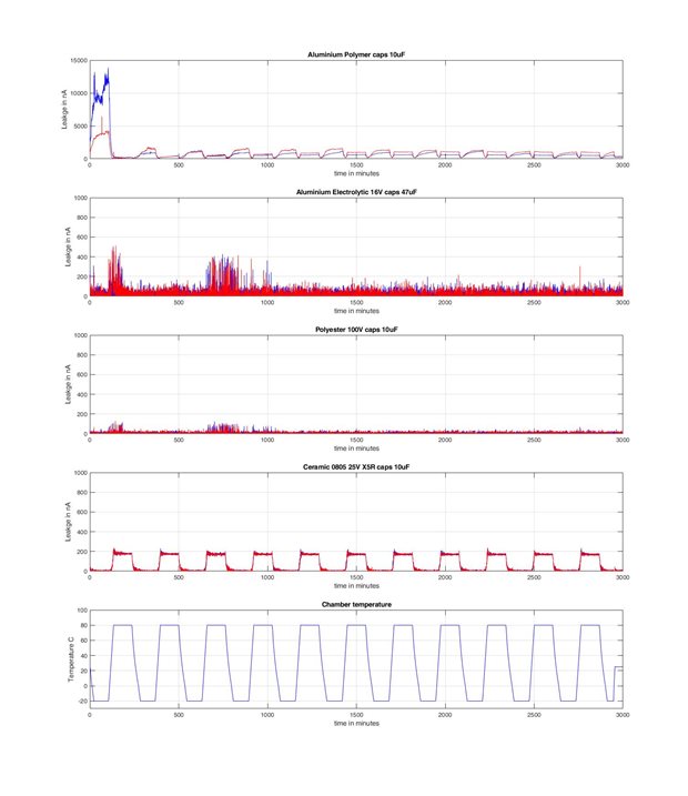

Test results, linear plot:

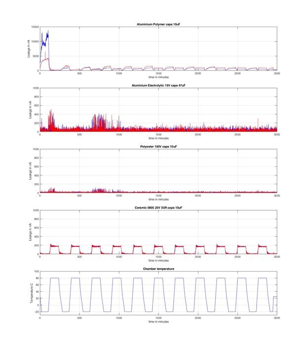

Test results, log plot
There a few interesting things in the results.
First some general points:
The system noise was too high (more on this later) and there was some kind of a noise burst during the first high temperature dwell time. Since it affected all for capacitor types and wasn't repeated we'll ignore it.
This was one test of a very small number of parts - beware of this and don't get carried away with drawing conclusions.
As far as I can tell none of the parts was out of spec, so while I may talk about high leakage current please don't forget that highest value I measured was 10uA !!!!
The Aluminium Polymer caps had the highest leakage current, with much higher leakage current over the first cycle. There is evidence of the effect picked up by neuromodulator and once the capacitors had settled in the dt/dT effect was greater than the effect of temperature. My AlPoly caps had lower leakage when hot than when cold.
The unexpected star of this test was the Aluminium Electrolytics from Rubycon - leakage current average less than 10nA (over temperature) and cheap - about 10p each. I measured the ESR at about 0.3R.
The Vishay Polyester capacitors are huge, rated for 100V, quite pricey and very low leakage. They are mainly included here as a reference point. The ESR is very low as well. They would be great in filters but not normally much use in power supplies (self resonant frequency is 390kHz for this part, lower capacitance values are much better).
The Murata MLCCs are a bit of  a mixed bag, my capacitor tester had trouble measuring them - giving silly (high) values of ESR at low frequencies and low capacitance values at higher frequencies. The leakage current is very temperature dependent but well within spec.

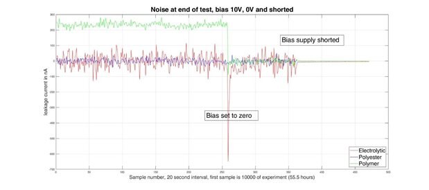

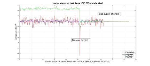

Noise
Once the test was complete I let the system settle and stabilise for several hours at 25C and took some more measurements as I set the bias supply to 0V and then shorted it out:
When the bias is reduced to 0V the leakage current disappears as would be expected but the noise continues until the bias supply is shorted out. It looks as if noise from the power supply is bad enough to cause a problem here so I shall experiment with filtering it.

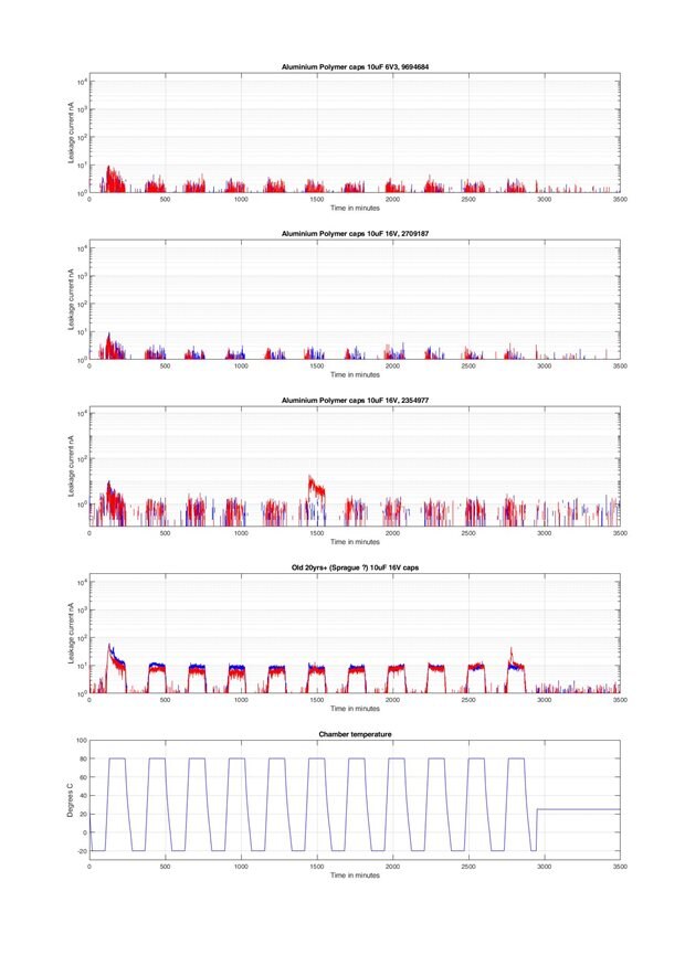

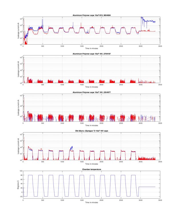

More Testing 4th JULY 2019

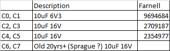

Since I was unable to duplicate neuromodulator's results with the capacitors I had to hand I bought three different types of surface mount Aluminium Ploymer capacitor for some more tests.
C0, C1 are the same type that NM tested.
C6 and C7 are included in the hope of seeing something really bad, and checking out the commonly held belief that electrolytic have a poor shelf life.

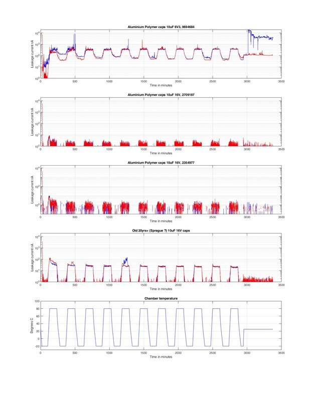

I added a filter to the power supply (56R in series and then 33000uF to ground, this reduced the noise considerably - down to about 1nA RMS
For the first test run I used 5V bias to respect the ratings of C0 and C1
In each of the first four sub graphs the blue trace is C0,C2, C4 or C6 and the red trace C1, C3, C5 or C7
Very little seems to be happening with 5V bias so I increased it to 10V. (NB C0 and C1 are only rated for 6.3V).
Now things are a bit more interesting, C0 and C1 leakage has incensed significantly and after several temperature cycles C0 could be said to have
failed (except that the leakage current only peaked to about 3.5uA which isn't actually out of spec and I was over volting it !)
The old electrolytic comes out of this pretty well, leakage current rising to about 30nA at 80C with 10V bias.
There is a little evidence of a rate of change of temperature effect but it seems to mainly affect only the first temperature cycle of each test.
C0 and C1 show almost no rate effect and very low leakage current under fair operating conditions.
C2 - C5 only show a very small rate of change effect in the first cycle but the maximum leakage current is very low (max 10nA with 10V bias)
C7 shows the rate effect to a small extent right way through the test.
I was not able to reproduce NM's results for C0 and C1 but this could be for a variety of reasons:
my system noise, even with the filter, was a bit higher and this would tend to mask the effect.
my rate of change of temperature was a little slower (3C/min rather than just over 4)
we may not have handled the capacitors in exactly the same way (we both had to solder wires to them).
Conclusion
All the capacitors measured had leakage currents orders of magnitude less than specified (or below the capability of my test setup to measure).
The rate of temperature change does seem to affect the leakage current but at very low levels.
If equipment is designed to operate correctly at specified maximum leakage currents the effect of rate of change of temperature is very unlikely to be an issue.
None of the capacitors tested showed any tendency for degradation of the leakage current performance over the 10 cycle test (under permitted voltage bias).
Applying 10V bias to a 6.3V capacitor caused it obvious signs of stress but it was still within spec for leakage current at the end of the test.

    Very nice report Michael, the chamber and the parallel recording through a DAQ surely help a lot in making the testing much more rigorous! I'm currently working on designing a chamber to do what you just…
  • michaelkellett
    michaelkellett over 7 years ago in reply to neuromodulator +5
    There were two caps of each type, one is blue (caps 0,2,4,6) and the others (1,3,5,7) are red. Sorry for not saying ! I'll try a different rate - but I can only go slower ! I had my instrument on 100PLC…

    neuromodulator over 7 years ago in reply to michaelkellett
    Checking again your plots, the aluminum poly shows an interesting property, at -20 the leakage is higher than at 80. It might be interesting to perform a very slow ramp up and down to see where it reaches its minimum. I suspect that if the ramp is slow enough the leakage currents will be identical, independent of the direction of the ramp, unless capacitors "long memory".
    If you try different dT/dt try something like 2 C/min, 1 C/min, 500 mC/min, and so on, it may better highlight the effect of the dT/dt over the leakage.
    I had my instrument on 100PLC and single reading - probably no a lot different.
    With the noise filter (56R, 33000uF) on the power supply I'm down to 1nA RMS noise.
    I may get my next test (with some caps exactly like yours)  started today before I'm away for three days  - depends on Farnell and UPS.
