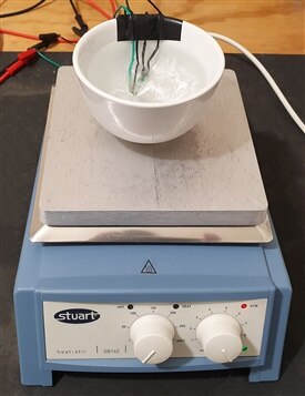

I soldered cables into the capacitors and then waterproofed them with hot glue. The quality of the waterproofing was tested by checking if the DMM measured a capacitance changed after immersion into water (oil would have been much better but water was what I had at hand). As the Keithley DMM6500 measures the capacitance by measuring the voltage slope while supplying a constant current to the capacitor, a parallel resistor (water making contact to both terminals) would have the effect of making the DMM display a higher capacitance. The hot glue waterproofing appeared to work well as in none of the 3 capacitors I noticed any increase of the measured capacitance after immersion.
I used a hotplate magnetic stirrer to heat water of a recipient and avoid a temperature gradient buildup (as water is stirred through a coupled magnet).
Temperature was measured with a thermistor and a NI MyDAQ, which is an inexpensive DAQ that comes with a built-in DMM. Capacitance, current and voltage where measured concurrently with a Keithley DMM6500.
