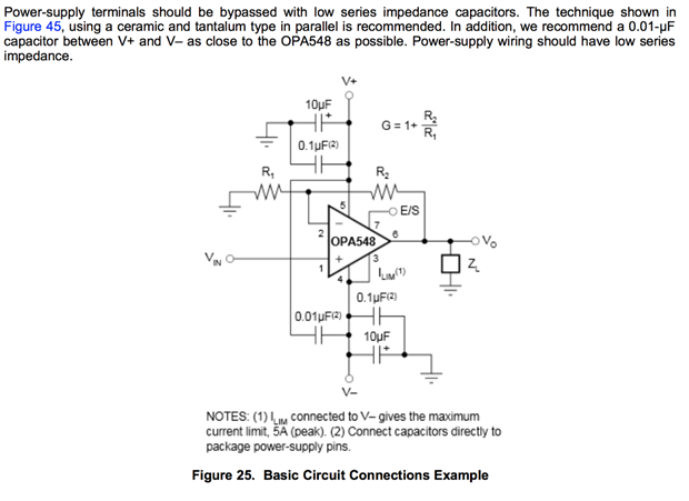

I am basing my work around the current amplifier circuit that I entered into the Electromagnetism Project14 competition, alongside the current clamp tables that I was winding. Some original comments around the supply de-coupling capacitors on the amplifier were that they may need to be increased. I have very little knowledge on the subject, and therefore I just stuck with the design concept detailed in the data sheet for the OPA548 from Texas Instruments.

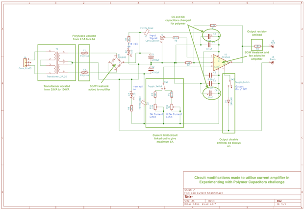

The original current amplifier circuit utilised a 10uF electrolytic on each supply rail in parallel with a 0.1uF ceramic. This original 10uF capacitor was physically quite small, and in itself, presents a challenge in selecting a replacement capacitor, especially with an increased size. The supply rail to the amplifier is from a 9V dual secondary transformer, giving around 14V output at no load, after the bridge rectifier and smoothing capacitors. Voltage rating of the capacitors, therefore should not be a problem.
As I had spare printed circuit boards for the circuit, I decided to set two of them up for the experiments, one with electrolytic capacitors installed and the other with polymer capacitors. Both of these are fed from a single 100VA transformer, instead of having their own supply transformer. I also intended this circuit to be capable of a higher current output than the original 1A, and in the longterm I would utilise the set up to experiment with parallel and serial configurations of the amplifier output.
The circuit diagram below shows the circuit modifications made.

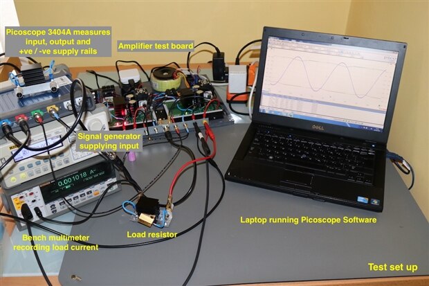

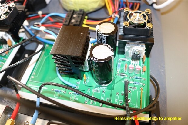

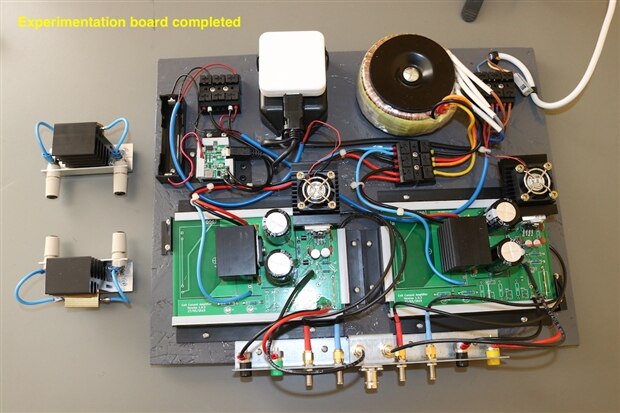

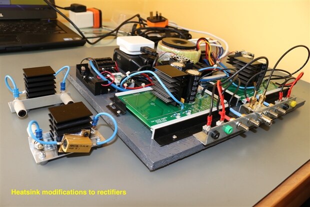

The test set up is an open board design to allow me to remove the PCBs for modifications relatively easily. Due to this, and due to the increased current output, heatsinks were added to the bridge rectifiers and a larger heatsink and fan were added to each of the amplifiers.

Rectifier heatsinks

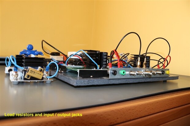

Output jack configuration

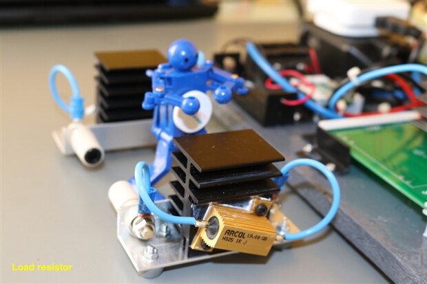

1 ohm load resistor and heatsink
The initial test set up is to only use a 1 ohm load resistor across the output of the amplifier. The intention is to get up to the 3A maximum continuous output rating of the amplifier and potentially the 5A absolute maximum if possible. The current amplifier for my application is only required to operate between 50Hz and 20kHz, so these are the frequencies I will be concentrating on.

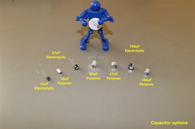

I have specifically looked at the Panasonic SEP and SEQP series of capacitors for the replacements. A 10uF capacitor is only available within the SEP series and I have struggled to actually obtain one within the UK, ending up with going for a special order. The SEP series are also a bit larger than the Rubycon 10uF capacitor installed, so I therefore looked at other manufacturers offerings. A Kemet Polymer capacitor from their A758 series was easily available and was of a more suitable size for replacement.

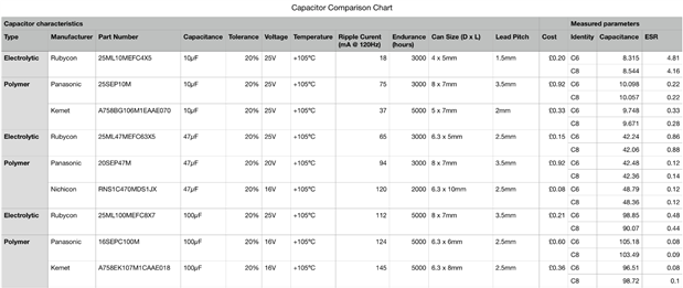

A 47uF polymer capacitor was more readily available from Panasonic from their SEQP series, as expected it is a little larger than the 10uF, but should still fit within the board. There is also a 47uF Polymer capacitor available from Kemet, that is again more favourable in size to the Panasonic. A 47uF electrolytic capacitor from Rubycon is also available to provide a performance comparison against.
The table below summarises the capacitors I have and intend to utilise in the tests. Their basic characteristics show that they are reasonably well matched in terms of capacitance value tolerance and operating temperature. The majority of the capacitors are 25V rated, but as the capacitance increases, the polymer capacitors drop to 20V and then 16V at 100uF. A 20V version is available at 100uF from Panasonic, but its physical size is a little too much for my test board.
The can size and lead spacing does vary between the different types and the different manufacturers. In general Panasonic seemed to produce a physically larger capacitor than the others, which can lead to issues installing them on existing designs. The maximum ripple voltage varied, according to the can size and type. The lowest ripple voltage ratings were for the electrolytic capacitors, with the larger polymer capacitors from Panasonic having the highest ripple capability.
Cost is also another factor when selecting components. The prices given in the chart are UK based, excluding VAT and for minimum order quantities of 10 or less. Larger quantities would have a considerable discount in comparison. As a general guide, the polymer capacitors were more expensive than electrolytic equivalents. However, it can be seen than the endurance at rated voltage and temperature was usually higher for the polymer capacitors, with the exception being the 47uF capacitor from Nichicon.

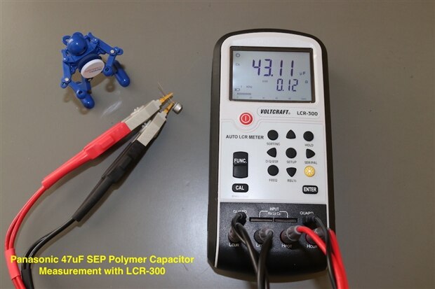

I have identified specific capacitors for installation into the C6 and C8 positions and carried out physical measurements of their properties. Naturally I do not have the ESR70 capacitance meter. I do have access to an Applent A2718A bench LCR meter and a Voltcraft LCR-300 handheld LCR meter. Strangely, the more expensive bench unit from Applent, does not have the ability to carry out an ESR measurement, but the LCR-300 does and so the checks were carried out using this instrument.
For the test measurements on the amplifier boards, I will supply the input signal using a sine wave generator and monitor the waveforms using a Picoscope 3404A. A separate measurement will then need to be made with the Picoscope of the ripple on the positive and negative DC supply lines. The output current from the amplifier under tests to the load, will be verified with a bench multimeter.

    I have laid the board out in a logical manner for me, but it could do with a bit more space around some of the connectors. I was going to add a switch for the fans in the top left corner, but decided I would just let them run all the time for the short use that the board gets.
