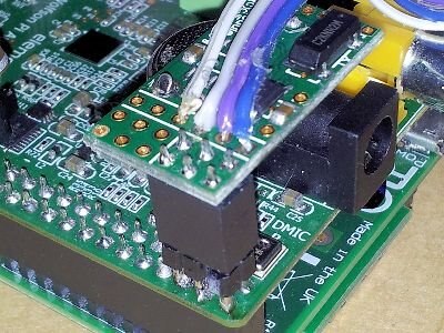

Raspberry Pi provides GPIO on P1 and P5 connectors. Both these connectors are occupied by Wolfson Sound card.. Two on these GPIO are available on Wolfson card.  In our project we need 5 GPIO. Hence the two questions:
1. Of the GPIOs on P1 and P5 which ones are NOT used by the Wolfson sound card?
2. What is the best way to phyiscally accesses these GPIO.
We would not be able to use the Wolfson sound card if we do not get access to in total 5 GPIO pins. Please assist.
    I think your options are:
    1. Wire an I2C interfaced GPIO expander to the Pi I2C pins in parallel with the Wolfson card. Maybe PCF8575, or MCP23017.
    2. Use a microcontroller on Pi I2C or serial port to handle your I/O. Serial port is accessible at pins on the WAC.
    3. Use a USB I/O device
    4. Use a different audio device that doesn't monopolise the GPIO.

    I suggest you use a i2c port expander or USB I/O device.
    I have a real-time clock module connected to header pins I have soldered onto the Wolfson to connect the i2c. It works and seems to cause no problems with audio.
    By soldering two full rows of header pins to the top of the Wolfson you get a stacking connection to support a standard Pi expansion board. As long as any board you add doesn't use GPIO other than the i2c, and doesn't conflict with an i2c address on the Wolfson, it should work.
    IMPORTANT check carefully that any card you attach does not use other GPIO lines or you may damage something.
    Insert the pin headers into the female connector of your daughter card to maintain proper alignment. Position the pins over the pins on the Wolfson and carefully solder the pins at each end of each header strip. Solder the pins along the edge then remove the daughter card to access the pins on the inner strip. Be careful not to short the pins solder. Be careful when plugging or removing a daughter card.
    You could use the HobyTronics expander in this scheme.

    e14 Contributor over 12 years ago in reply to e14 Contributor
    Only two GPIO are available on header pins on the Wolfson card - UART0_TXD (GPIO14) and UART0_RXD (GPIO15).
    The Pi I2C does not route to the expansion header on the Wolfson card. If you want to connect a port expander I suggest soldering a 2 x 3 pin header to the top of the wolfson board at the Pin 1 end to make the I2C pins available to expansion boards and jumpers.
    I have soldered such a header and attached a RTC module to it. You could attach a gpio expander by jumper wires. Here is a photo showing the soldered header pins and RTC module. The flying leads from the RTC board connect to a GPIO expander.

    Also GPIO3 on expansion header is available (connected to GPIO3 of WM5102 and to P1 pin 22 of RPi). I guess it can be used, else they wouldn't expose it on the expansion header.
    The P1 i2c is used to control the WM8804 SPDIF chip, but I see no issue in connecting another devices to the bus as suggested.
