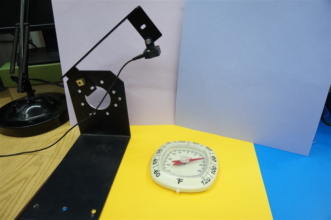

  1. Setup the bench testing equipment and collect images for the dataset.
            I used a 3D printer to print an enclosure for Arduino Nicla Vision module. Here is my small bench studio:
                                 Fig 4:   ZinnBee Bench Photo Studio

              3. Performance evaluation of Edge Impulse
             I did multiple iterations to get a good ML result on the bench testing. I selected 3 Edge Impulse training cases for this blog.
             Edge Impulse training case 01: exact procedure as Ref[3]. The training accuracy is about 81.8% for my dataset.
Fig 5: Edge Impulse training case 01: RGB Image + 20 Training Cycles
            Edge Impulse training case 02: updated the image from RGB to grayscale. The accuracy  of the training model is 90.9%.
Fig 6: Edge Impulse training case 02: Graycale Image + 20 Training Cycles
             Edge Impulse training case 03:  the image is set as grayscale and upgrade the number of training cycles from 20(default) to 40. The accuracy of ML training model is 100%.
Fig 7: Edge Impulse training case 03: Graycale Image + 40 Training Cycles
 I took a short video for the bench testing of the deployed case 03.Edge Impulse training case 03
Part 03:  ZinnBee  Analog Meter Reading Experiment Summary
I reviewed the dataset I uploaded into Edge Impulse and the corresponding labeled images as below:
                                                 Fig 8: Images Labeled Normal and High (no other image between these two)
These two images are at the edge for the classification between High and Normal. I did give Edge Impulse ML flow a challenge for the classification of the experiment. The bench testing on case 03 shew that Arduino Nicla Vision module thought the temperature was constant high from all the angle of the camera view. More work will be needed for ML flow on my next blog.

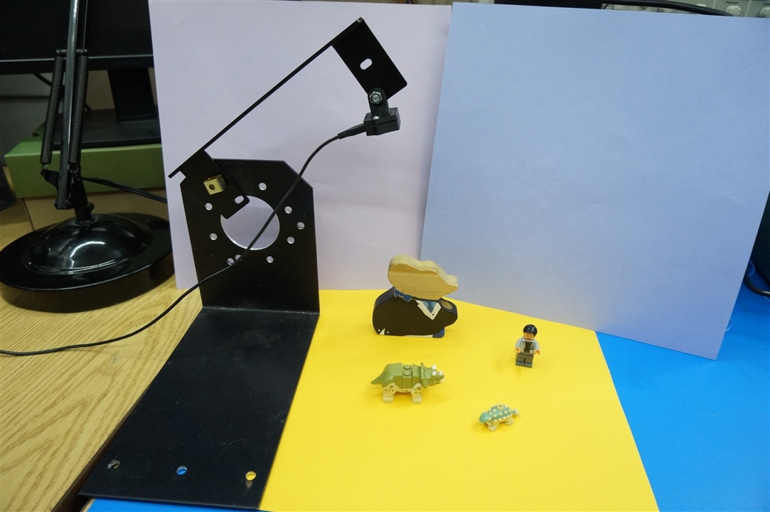

  Part 04:  Kick off ZinnBee Lego-lab ML Experiment
I kicked off ZinnBee Lego-lab ML experiment last week. However, there were some interested results from the Edge Impulse ML flow I could not understand well. So I came back to finish the blog on ZinnBee Temperature Meter experiment, which could be an aid to guide me to finish ZinnBee Lego-lab ML experiment. Here is my ZinnBee Lego-lab content.
Fig 9:  ZinnBee Lego-Lab ML Experiment Setup
There are 4 objects: boy, mice, big dinosaur and tiny dinosaur. ZinnBee Lego-lab experiment need to identify 4 different objects properly. I will describe the process of the experiment on my next blog.
