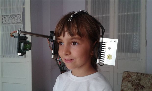

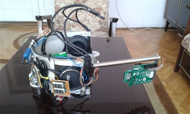

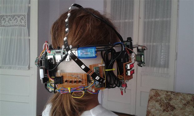

In the last post, you could see and hear Cybernetic Computer Interface in action operating inside a box. But Cybernetic Computer Interface is supposed to be a wearable device so let's make it so.
At this stage of construction, initial ideas about how mechanical structure should be made proved wrong and involved a lot of back and forth testing and redesign.
Because of the weight, in the end I had to add additional structural elements to make the device wearable.
One of the biggest problems was to put everything on the quite small frame.

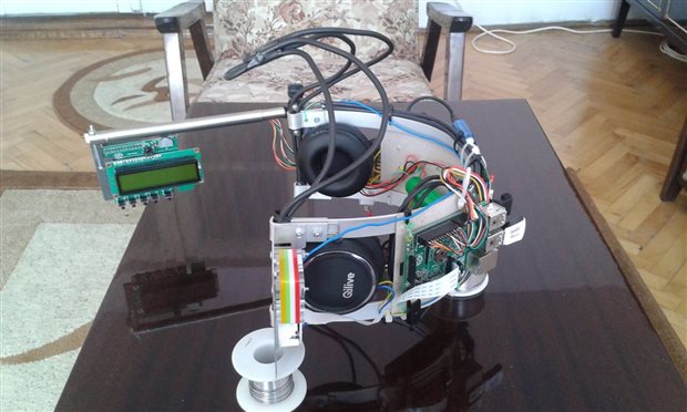

The frame is built from aluminium strip, which is also light, flexible, strong and easy to work with. I need it to be flexible to allow the whole structure to
squeeze against the head and sit as tight as possible.

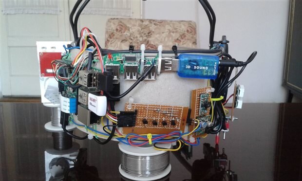

All boards are mounted on this frame with zip ties and wires in order to allow them to move without create mechanical tension in the boards, to avoid crack them.

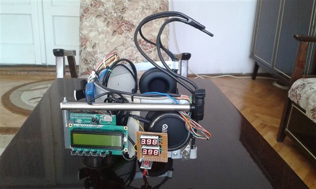

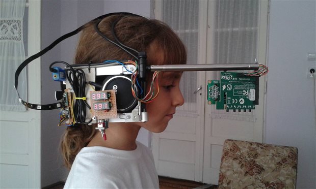

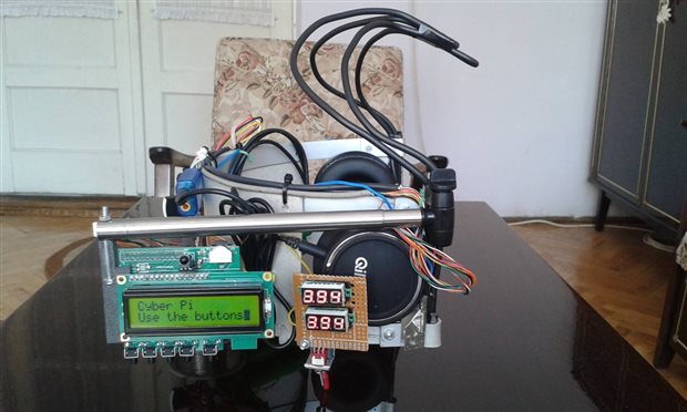

The hardest point was to make the moving arm for Control and Display module. This should be mounted on the frame, must be extensible to allow an easy reading of display
and needs to be strong enough to not bend or break under the weight of CAD module (ask me how I know image ).
The actual version of the arm is made from a hacked selfie stick image
Also all power and control lines from RPi to CAD had to be long and flexible enough to allow mechanical parts to move. After trying MANY types of cables,
I end up using cables recovered from dead computer mice, which proved the best choice so far.
On the right side of CCI, I added two small voltage indicators, one for each LiPo cell. These have their own switch in order to be checked alone from the rest of the system.
Since the last post, the software was also improved with SDcard and USB drive support but voice recognition support is still not present.
Because of the large (and unforseen ) quantity of time involved in mechanical side development and building, I did not manage to build the outer shell and mount everything as I hoped for the final presentation, so this is the current state. Working but not finished.
I hope I will finish to build the outer shell in the next weeks and show you the completed device.
Here you can see different views of the device and a short demo movie.
Aaaand my assistant beta testing the product image
In the next weeks I'll build the outer shell and post here the final version with all planned features.
Thank you all for following Cybernetic Computer Interface building thread and I hope you found an interesting and informative journey.
All the best
-=Seba=-

    The display arm and its positioning were one of the most difficult part of the mechanical side.
    -=Seba=-
