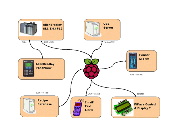

Here was the premise of my project:
I was able to complete all of the communication necessary for this project. It is difficult to show the FTP transfers.
One of the things I will continue to work on is adding a web server interface for the configuration of the communication channel.
