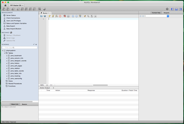

As the database connection is established it is shown the main SQL editor page. The following image shows the RPI master database where the only schema is the PhpMyAdmin, that was already installed on the raspberry PI, for testing purposes.
One of the most important differences between the MySQL Workbench and PhpMyAdmin is that with the workbench we have a top level vision of the installed MySQL engine with a better and wider control over the architecture. Who is used to manage server databases with PhpMyAdmin known that it operates from inside the database and it is not possible to have this kind of scenario.

The following images shows a first advantage of having the full control of the MySQL engine: all the users, connection, server status and more can be checked in every moment including a good traffic monitor while the database is running serving other users.
But I think that one of the most interesting features of the workbench cover the database design aspects. After the essential components of the database has been defined - like in this example the PhpMyAdmin database tables, we can use it to generate and then edit graphically the data queries, tables relationship and more.
