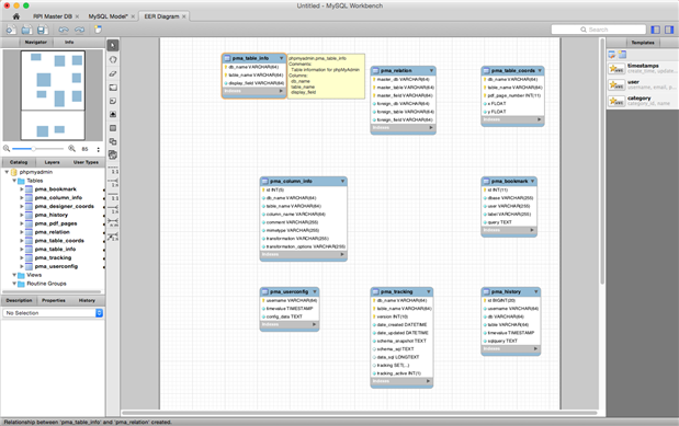

But I think that one of the most interesting features of the workbench cover the database design aspects. After the essential components of the database has been defined - like in this example the PhpMyAdmin database tables, we can use it to generate and then edit graphically the data queries, tables relationship and more.
Starting from the MySqlAdmin tables definition with a simple automated wizard the database tables structure has been extracted and generated graphically like shown in the image below.
The database designs can be organized visually to easily create the documentation like ths simple example in the attached pdf; the design is also interactive and can be used to expand the database features, complete the tables relationships, creating queries, procedures etc. in a comfortable visual environment.
