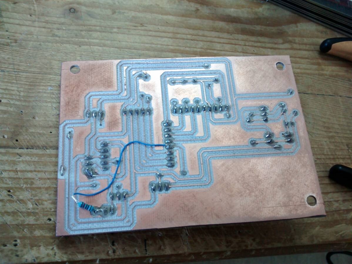

After a final check the schematic is expected following the previous tests done with wires and breadboards so the final PCB prototype has been milled as shown in the images below.
As shown in the final circuit assembled image, only the control components as soldered on the board (mainly the various pull-up resistors). As the board should be fit in the Meditech box and connected to the elements installed at different distances, all the other components are wires with connectors.

    So you have your own mill?  Did you build or buy it?  image
    balearicdynamics over 11 years ago in reply to screamingtiger
    All the boards are milled. Then if needed when I am sure that the PCB proto is 100% correct without problems I send to make 10 pcs to Eurocircuits.

    Did you mill this board or have it sent off?  Also what software do you use?  I need to get a PCB software.
    Board issue
    While testing the final version I have found an issue due a mistake on the schematics (I will correct the related post asap). The pull-up resistor in the LID switch was placed in the wrong place so the result is that the lid switch appears always open instead of detecting the real status. Just done a pcb correction on-the-fly.

    You'll be my lucky number. I am just adding a comment to the last about an issue I have found in this moment image
