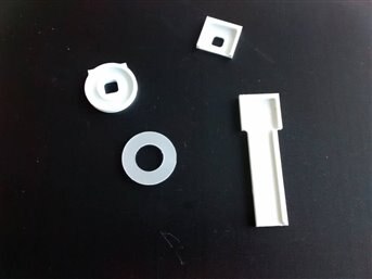

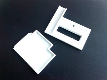

Case design improvements
The Meditech eye probe camera is conceived to work nearby the main device component for easier usage. The camera position with the RGB light ring (see the image below) in the case prototype is fixed but need to be able to rotate and should be plied when the module is not in use to fit better in the component side of the case. This means to redesign this part of the case adding this two movements. As this part is the cover of the camera flat cable, it does not affect the circuitry and connections.

    Hi Joey, not these parts are faster and easier to make with the Mill machine. There are some parts instead like the temperature probe that are smoothed that will be done with 3D printer in the second testing…

    not these parts are faster and easier to make with the Mill machine. There are some parts instead like the temperature probe that are smoothed that will be done with 3D printer in the second testing version of the Meditech.
    Enrico

    Did you 3D print those little parts?
