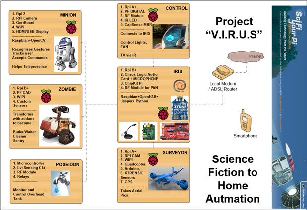

I have a habit of biting off more than I can chew and this design Challenge will be no different. Bear with me as I explain the basics of my project. My complete proposal is a 'bit' longer than this particular post and I will be explaining my evil plan for project virus here. Lets go!

Each module is explained in brief in the proceeding sections. The overall diagram of the system is shown below and as a requisite of the challenge, their inspiration is also mentioned.
The most important thing about this design is the design and use of "Transformer" Robot which can be modified to perform a multitude of tasks. In the proceeding sub-sections I will explain the sub modules to be made, their design and what problems they solve.
The Central Controller - IRIS
Inspiration - JARVIS from the Movie Iron Man Series and SKYNET from Terminator Series
Description: The name IRIS was used for the computer in the Sci Fi Cartoon Series Johnny Quest and it will serve me here as well. The idea is to have a central computer that can act like the controller and data accumulation point for the entire home.  It will sit in my home office/workshop and will accept voice commands via the CIRRUS LOGIC AUDIO CARD which will be processed via Jasper(JARVIS). It will also run OpenHAB which will be used to issue commands to the various sub-modules and robots(SKYNET). The CHIPKIT PI will act as a layer of abstraction between the RPI and the RF Interface which is used to create a PAN. If the need arises, the RF modules can be upgraded and other means of communications can be introduced such as two wire etc and the CHIPKIT can be programmed to accommodate that functionality as well as offload the network management tasks.
It will perform functions of data collection, sending commands, alarm, light, robot etc control as well as voice enabling the office.
