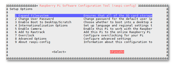

Enabling I2C and SPI on the RPI
By default the I2C and SPI interfaces on the RPi are no enabled. We need to make some changes.
First type the following command in your command prompt
sudo raspi-config
This will start the utility as shown below
Go to Advanced Options -> I2C -> Yes
The screen will ask if you want the interface to be enabled :
Select “Yes”
Select “Ok”
The screen will ask if you want the module to be loaded by default : Select “Yes”
Repeat the same for the SPI module.
