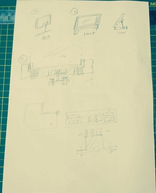

Before I even start the computer, I need to analyse what I need. This means dimensions and a rough drawing and hence usually, I start with a piece of paper and pencil to make a rough sketch of what I need.

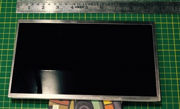

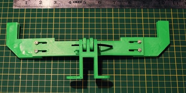

Here my requirement was that I have a 10.1” LCD which needs a sort of ‘stand’ which is a bit flexible. Hence I started on a paper to try and make possible solutions. The image below is my first rough sketch of three designs I though would be useful.
I chose design C because it was a solution which is flexible and can be used for other display sizes as well. Additionally, it uses the least amount of material and hence it was the obvious choice.
Step Two: The dimensions
After I have a drawing in hand, I need to add dimensions to the lines. The dimensions of the LCD are measured and then the drawing is finalised. It takes some time but the drawing is complete. In my case I need dimensions of the slots as well as the thickness. The cel robot has a 20 Micron thickness resolution and a 0.8mm thickness nozzle and a 0.3mm hence I will chose dimensions in multiple of these so that prints are precise.

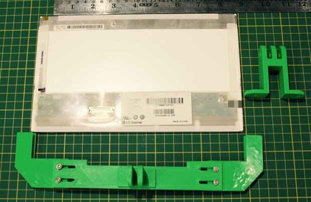

With these considerations, I designed the frame using google ketchup.
Step Five: Press Print
The second last step is to send the files to the 3D printer. The results may vary depending on the 3D printer.
Step six: Putting things together

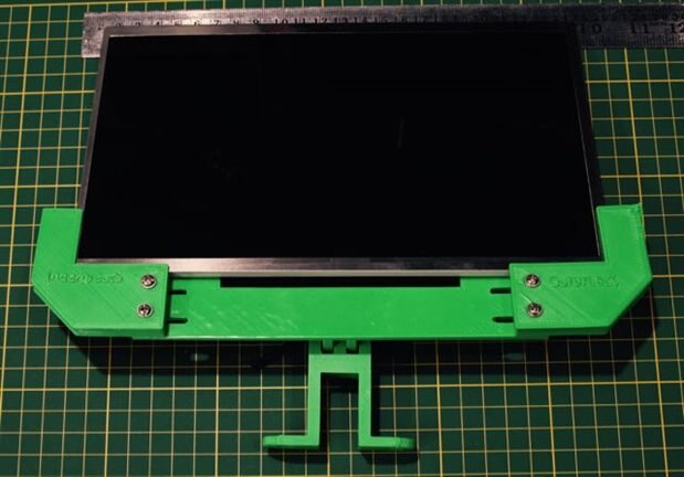

The final step is to see if you did everything right or not. In my case the assembled print is shown in the image below.
Conclusion

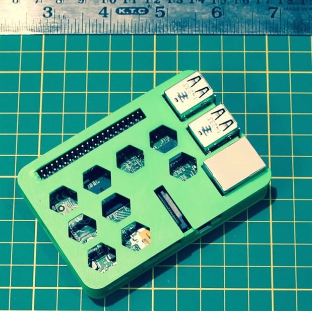

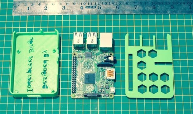

I got things to work and as you can see its a good fit. I hope I have helps you make a better print and if so then gimme a shout out. I also made a Raspberry Pi case and I am attaching the pictures at the end.
