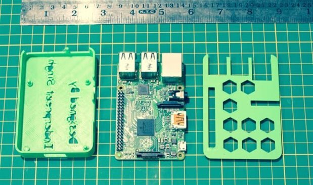

Step One: Decide what you want
Before I even start the computer, I need to analyse what I need. This means dimensions and a rough drawing and hence usually, I start with a piece of paper and pencil to make a rough sketch of what I need.
Here my requirement was that I have a 10.1” LCD which needs a sort of ‘stand’ which is a bit flexible. Hence I started on a paper to try and make possible solutions. The image below is my first rough sketch of three designs I though would be useful.
I chose design C because it was a solution which is flexible and can be used for other display sizes as well. Additionally, it uses the least amount of material and hence it was the obvious choice.
Step Two: The dimensions
After I have a drawing in hand, I need to add dimensions to the lines. The dimensions of the LCD are measured and then the drawing is finalised. It takes some time but the drawing is complete. In my case I need dimensions of the slots as well as the thickness. The cel robot has a 20 Micron thickness resolution and a 0.8mm thickness nozzle and a 0.3mm hence I will chose dimensions in multiple of these so that prints are precise.

Step Four: Making things
We have the drawing on paper and it should be pretty straightforward when converting into the 3D models. However not everything that can be designed can be printed. There are a couple of things that you need to keep in mind when you design for print, you need to consider the following.
1. A 3D Printer cannot print in air and so you need to design edges that have supports. Most of the time this can be done by the software like mesh maker from autodesk but its always better to have a design that can be printed the way you designed it
2. Don’t design small posts and columns unless your 3D printer can support it. A lot of the time we design thin details like line and posts which cannot be fabricated.
3. Know the limits. Every 3D printer has a print volume which tell you how big your 3D print can be. If your final object is larger, you need to either split it into pieces or design it with joints.
4. Material thickness considerations. Try and design wall thickness in multiples of nozzle size so that its comes out just right.
With these considerations, I designed the frame using google ketchup.

The final step is to see if you did everything right or not. In my case the assembled print is shown in the image below.
Conclusion
I got things to work and as you can see its a good fit. I hope I have helps you make a better print and if so then gimme a shout out. I also made a Raspberry Pi case and I am attaching the pictures at the end.
