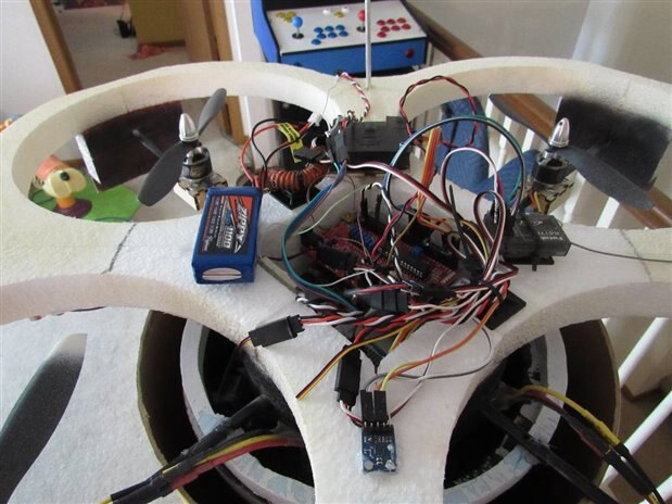

Well this project was a great challenge and I LOVE my new QuadCOP.  I think I may rename it to DRIOD COP since I made the look akin to Star Wars droids.

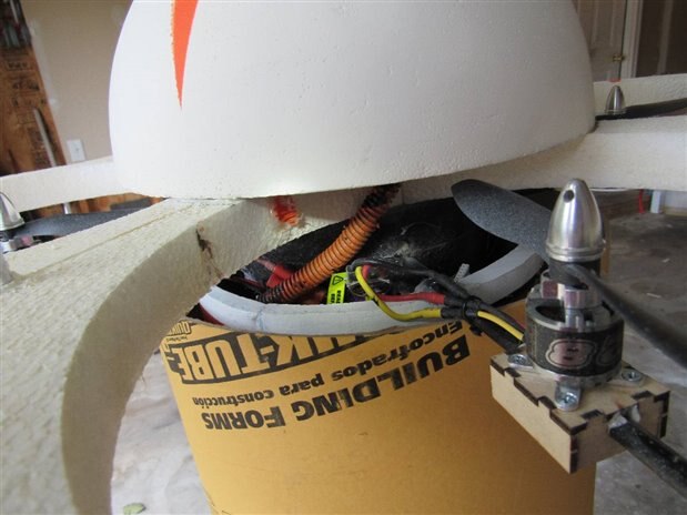

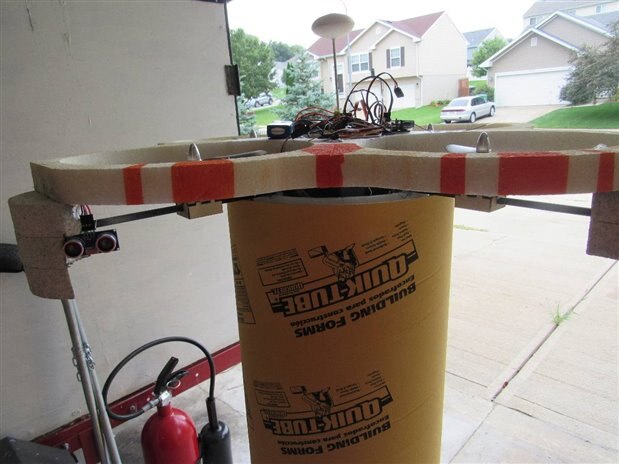

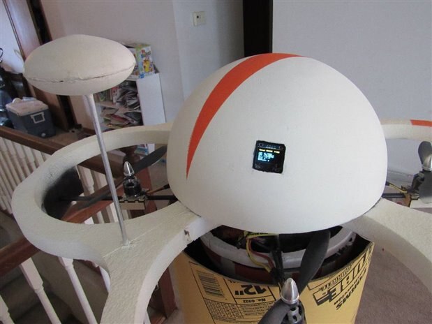

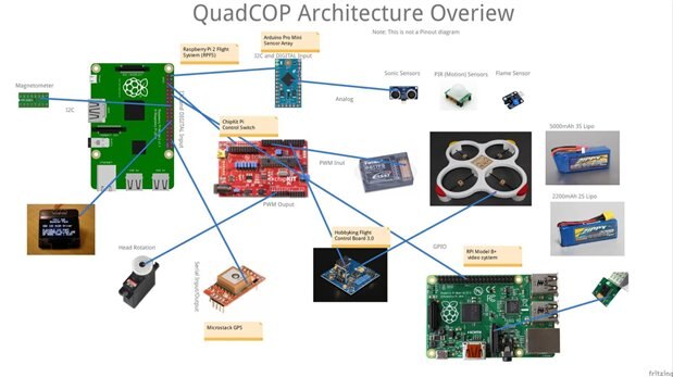

I want to provide a high level picture of the final hardware:

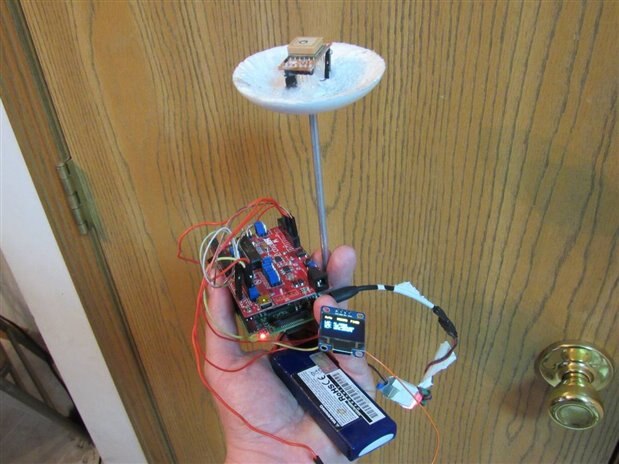

Here is the final walk around of all the hardware and elements I have used.
Parts Used from Kit:
  • Pi 2
  • Pi b+
  • Raspberry Pi Cam
  • ChipKit Pi
  • Microstack GPS
  • Xtrinsic Mems Board (still under testing)
  • Pi Shim RTC
Things I added from original design:
  • Custom Protocols
  • Moving Head
  • Use of ChipKit Pi instead of Arduino (huge learning curve)
  • Custom built quad body (instead of buying one)
Things I didn't get done in original design:
  • Sound Card
  • Motion Sensor
  • Sending of Text Messages (Logging is still done)

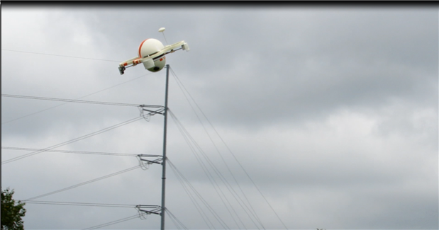

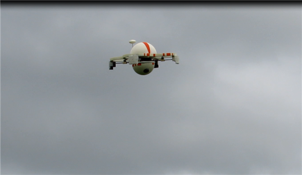

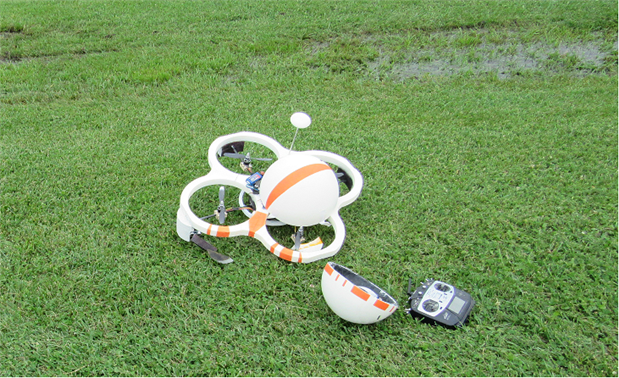

I have yet to test the waypoint navigation as I am out of time, but I will be testing that this weekend, I will add the video to this post.   Currently what I am testing it the "loiter" functionality, that it the QuadCOP attempts to stay at a specific heading and GPS location.
I am new to this hobby and did not account for the huge learning curve with some of the systems.  I also lost a month for a family vacation and wish I would of taken the project with me!
As a final fairwell I went out in high winds and did one last test of the loiter and also flew the quad around a bit.  The winds were very high and I wanted to see how well the quad held.  Unfortunately the camera cut out after 1 minute.  This flight was CRAZY and the QuadCOP was trying hard to holds its place.  I had to take control back a few times.
I attempted a very low loiter and the quad headed towards the ground.  There was a puddle on the ground and I think it messed up the sonic sensor, and it hit the ground!  You can see the puddles.
Since the head came off, it unplugged the RPi B and the camera, and the video didint record from inside the head.  The repairs seem minor so I am going post more vid tomorrow with a 2nd retry.
Conclusion
Thanks Element 14 and EVERYONE for your help and support.  I didn't get as much done as I wanted and my documentation is not as nice as I am capable of.  But rest assured in future projects my abilities and quality will continue to rise!

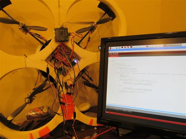

This project allowed me to use C++, which seems to be a dying language in the everyday workplace.  C++ is dear to my heart and thoroughly enjoyed coding the QuadCOP with a real language.
My family participated including holding things, getting tools, painting, and putting up with a grouchy dad!  Time with family is never wasted and as such I am very satisfied with my project.  I will continue it on forever as it will never be considered complete!  I have an awesome new RC toy with unique functionality and I plan to fly this around at my club giving demos.  It is a real show stopper!
