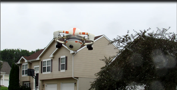

I was very nervous.  I turned the loiter on for just a second and it held then started dropping, the ground sensor caught it.
Because my controls are being passed through the chipkit pi, there is some  resolution lost so its a bit touchy for a hover..
A few messy pre flight pics, and the video.  I am going out to get a better flight and test some more of the functionality.  Today is a busy day.

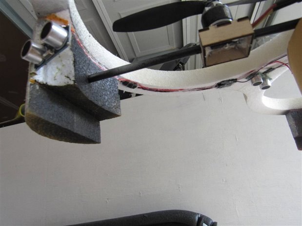

Messy but secure.  Covered up by the top head so who cares!
Ping sensors.  Only 2 of 4 installed.

I have to go fly more, no time to waste!  The last few seconds of the vid is the loiter, I yelled STOP because I thought it would crash into the ground.  It got very close but the triggers worked and it detected ground!  WHEW
BTW the head is moving by itself as intended, I need to fix up the moving algorithm, its pretty plain.
