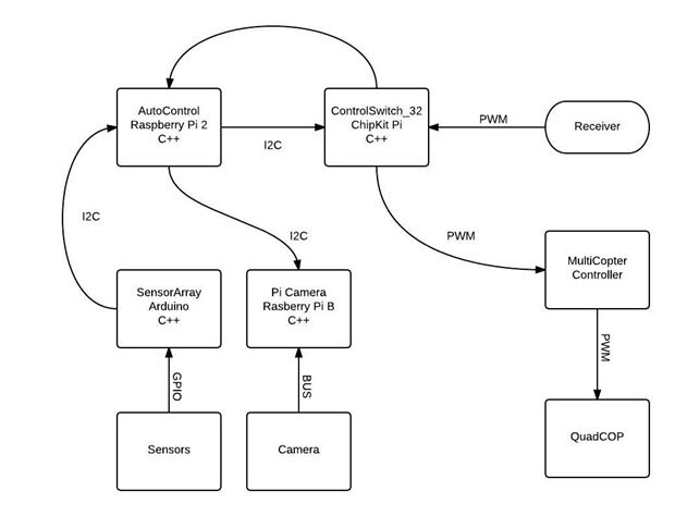

Later today I will be publishing my code and flow charts.  One thing I am working on is getting an accurate heading from my magnometer.  I have an open question out there for some help, I also have ordered a new sensor just in case.  I expect by tomorrow to have it resolved.
However, In the interim its time to get this flying!  Despite the fact my magnometer is wrong, it is still consistent.  I cannot navigate to waypoints with incorrect heading information and the current readings I have do not adjust linearly to the correct heading.  But I do know where north, south, east and west are and I can adjust my heading to those specific headings.  What doesn't work is trying to get to NE, SE, SSW etc..
So, for testing here is the plan:
Go north for 20 feet, turn right, Go  east for 20 feet, turn right, Go south for 20 feet etc...
So basically the QuadCOP is flying a square.
At the end of each 20 foot leg, the QuadCOP will perform a sensor scan, by having the flight system move the head 180 degrees.  All of this will be automatic without any manual control!
I feel this will give a good test of the Rasberry Pi Flight System (RPFS) and check the control switch (ChipKi Pi) functionality.  The control switch is already working for manual control as it is relaying the PWM signals from the Rx to the flight controller.
A couple previous vids to show what I am talking about.
here is an explanation of the control switch:
Here is my first test of the control switch, which is reading the PWM from the RX and passing it to the flight controller:
For reference, here is the software and hardware flow, to be included again when I post the rest.  Drill downs are needed for each system.
I will be flying this evening and posting a video.
WISH ME LUCK!  Its time for this thing to Fly or DIE.

    Nice update! Now the architecture of your drone is more clear in my mind Thanks!

    I wonder if the current in your motors is interfering with your magnetometer? Can you wrap some aluminum around the motors and then try the direction? DAB

    Checking with a real compass is sure a good idea, just to find a reliable comparison. Then, why not trying with the simple demo in Python, the Raspberry PI and the magnetometer in the kit? Place it neraby…
    balearicdynamics over 11 years ago in reply to screamingtiger
    Checking with a real compass is sure a good idea, just to find a reliable comparison. Then, why not trying with the simple demo in Python, the Raspberry PI and the magnetometer in the kit? Place it neraby the same position and see what happens. Maybe also to consider that it is rare but occur some electronic components are natively defective...

    Everything I have done so far is with motors OFF  image  No power at all to them, they are disconnected while I am working for safety reasons.  If the magnets are bothering it, I would think it would also bother the magnetometer in my phone.   I set it close to the magnetometer on the quad, but far enough away to not bother it because it actually does affect it.
    I am also assuming my phone is right, maybe I should try checking with a real compass?
