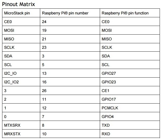

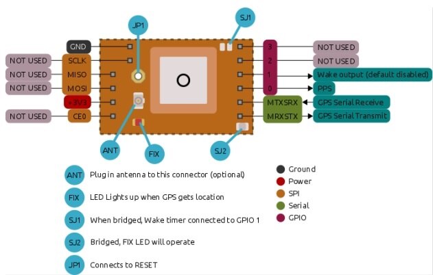

To get the current position I was planning to use the Microstack GPS module and the Microstack Baseboard. The datasheets for these are here - Baseboard and GPS Module.
This is where I encountered my first big problem. I hadn't really checked the contents of the kit and this means that I was not aware that I did not have a Microstack baseboard. As i had left this discovery till rather late in the day it left me with a dilemma. I could not realistically get a Baseboard in time so I needed a solution.
A little head scratching (and maybe a few choice words) later i came across this post on the Microstack GPS for Geochaching by callum smith. As well as a great explaination of how to use the Microstack GPS module to get current position there is also mention (in the comments) that it can be used without the baseboard.
So the plan changed and the GPS module will be used without the Baseboard. This can be done by connecting the appropriate pins on the module to the correct pins on the RPi.
The Microstack GPS module uses a python library available from Github. The libraries can be installed using apt-get:
General microstack node library:
sudo apt-get install python3microstacknode
GPS specific tools:
sudo apt-get install gpsd gpsdclients pythongps
Once done the GPS module can then be used to get position information required.
With the GPS Module connected up and the python libraries installed the current position can be obtained (using gps.gpgll).
This can then be used to pull out latitude and longitude numbers and the NS and EW indicators.

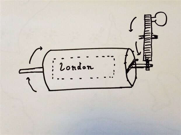

Getting Destination Position
The destination position is a little more tricky as I have set up a challenge for my self in the way destination is selected (I do not intend to use a screen or buttons as it would not fit with the aesthetic).
I have planned to use a selector system to indicate start and end positions on the device for route setting (described in my earlier blog - Sci Fi Your Pi - Prince Dakkar's patent log taking chart compass - Route selection and indication).
This is used to connect strings of LEDs to indicate the route depending on the position of the connections. I am intending to also use this to set the desired destination as well.
The plan is to use the connections on the wheel to connect a pin or combination of pins on the Raspberry Pi to set them High or low. Obviously the pins needed limits the number of destinations but using a combination of pins I can get a usable number of destinations from a relatively small number of pins. 4 or 5 pins which will give me 8 or 16 destinations (depending on how many destinations I can find LEDs for and fit on the scroll wheels).
The pin connections will use the same idea as the LED strings supplying a current to set pins high or not to set it low. The pin pattern will give a binary number that corresponds with the destination. Each destination will have a variable set with the longdtude, latitude and EW / NS indicators.
